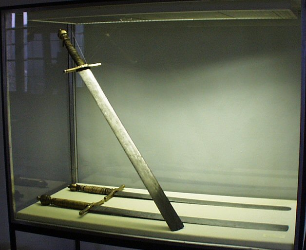

PostPosted: Thu 29 Jan, 2004 11:22 am    Post subject:         Reply with quote
From a museum in Salzburg.
 Attachment: 51.58 KB
Picture found on a Google image search.
