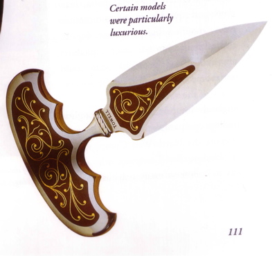

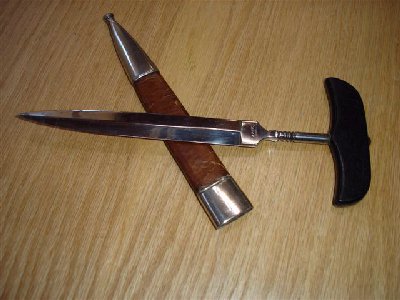

I’ve searched on myArmoury without much luck for something called a “push dagger.” I found these images in a book I bought yesterday, 100 Legendary Knives by Gérard Pacella. It was only $7 and has some beautiful pictures. Unfortunately, the text reads like a sales catalog and so I have my doubts about some of the information. I came across these knives in a section called “Knives of the Wild West”. According to the text, these are called push daggers and originated in San Francisco. The description says
”Discreet, and easily accessible, this push dagger had a short, jointed double-edged blade with a T-shaped handle providing good grip...Metal sheath with belt clip for rapid unsheathing...”
Anyway, there is no indication of exactly when, what time frame, these two examples came from or whether or not they are modern reproductions or museum pieces, etc. I would love to know more about these so I’m turning to you. Anyone have more information? Is “push dagger” the correct term? Did they really originate in San Francisco as a method of defense for professional gamblers? (That just doesn’t sound right to me, but it would be very cool if true.)

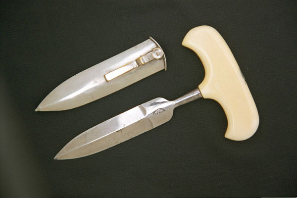

This is what I found for the first image below:
Alaskan Walrus Ivory Handle Push Dagger,
manufactured by Will & Finck,
San Francisco,
circa 1863-1880, 6¾in.
The second image came from: http://www.apacheria.com/edged.htm
It's description:
EW187-MICHAEL PRICE PUSH DAGGERThis is a push dagger from the great San Francisco knife maker Michael Price. It is 8-3/4 inches long with an ebony handle. It is in very good condition with a tiny bit of pitting on the tip which can barely be seen. The scabbard has iron mounts which are nickel plated as is the knife. The leather is in good flexible shape and is hand sewn down the back. The handle shows a lot of gentle wear to one side and the plate is worn off the bolster of the knife just below the grip. The Michael Price San Francisco mark is off center like all I have seen from this maker,. It is a good strong strike and looks just right. This knive has a very unusual form. I have seen others from other makers but this is not the typical more simple form. The handle turns a little which I have not tried to fix.

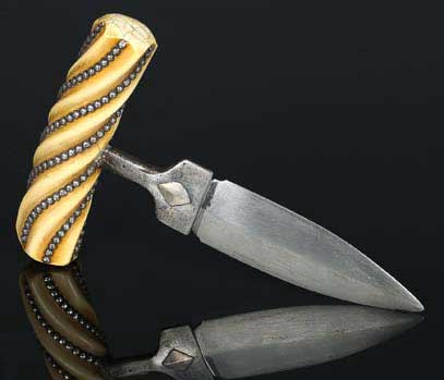

The third knife is from http://www.garyhendershott.com/bowieknives.html
It's description:
02 - HMC_296 - Mississippi River Ivory Push Dagger - ca. 1850- this was discovered in a Riverboat Gambling collection- it has a magnificent Ivory handle with silver rivets or studs thru out the double edge steel blade has a diamond design on it's ricasso. It's the finest and most visually attractive gambler's dagger we've seen, ex: Montague Collection.
And the last one is from Hanwei!
PAUL CHEN 2095 GAMBLER PUSH DAGGER
The San Francisco-style “Gambler” push dagger is a step back in time to the days of riverboats and stagecoaches, when gentlemen of the table considered this a vital tool of the trade. Recreated by Hanwei, the “Gambler” features a walnut grip, 2 ¾” 440C blade and a polished steel sheath with a spring-clip mounting attachment. A nylon sheath liner provides secure retention for handle-down carry. A protective padded storage pouch is provided.

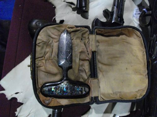

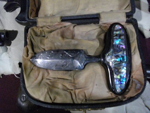

I saw this piece yesterday at the Baltimore Antique Arms show. My favorite part, though it's really hard to tell from my photo, is the gold playing cards on the reverse side of the handle.
I've done a tad more research on these pieces, and apparently they were popular with riverboat gamblers as well.
 Attachment: 34.44 KB
 Attachment: 34.48 KB
 Attachment: 19.83 KB
Gold playing cards on the reverse of the handle.
