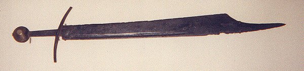

Here's an actual surviving falchion, apparently in the Musee de l'Armee in Paris, that bears a distinctive resemblance to that shown in the manuscript illumination of the apocalypse. It has the same odd point. This is what was said about it on the site I saw this:
A mid-late 14thC falchion with the edge on the convex side in the Musee de l'Armee, Paris.
It could be a bit earlier, based on its similarity to the falchion in the manuscript image.
 Attachment: 27.64 KB
Invalides Falchion
