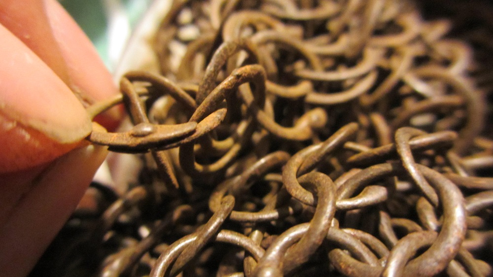

Ok, I took it apart and it appears that I have 3 or 4 different types op chain mail. I will try to be as specific as possible.
First one consists of a pattern of 4 flat rings, 11mm in diameter, which are linked with 1 round ring (not flattened) also 11mm in diameter.
Second one, flat rings about 11mm in diameter, 4 in 1, but all the same. This piece starts with 1,5 mm thick rings but the rings seems to get smaller after about 20cm.
Third one is completely different. The rings are large, 14mm in diameter, whole flat and only 1mm thick. This piece is very light.
last one, thick rings, 11mm in diameter, 4 in 1. Heavy piece.

Mart Shearer
Posted: Mon 24 Feb, 2014 12:15 pm Post subject: |
M Hermes wrote: | Ok, I took it apart and it appears that I have 3 or 4 different types op chain mail. I will try to be as specific as possible.
First one consists of a pattern of 4 flat rings, 11mm in diameter, which are linked with 1 round ring (not flattened) also 11mm in diameter. |
It appears that this is of demi-riveted construction, with the round rings being riveted and the flattened rings being solid. Can you find a missing rivet within the piece? It appears that the rivets are domed on the visible side. Is the reverse side similarly domed, or does it simply appear to be a piece of round wire?
Quote: | Second one, flat rings about 11mm in diameter, 4 in 1, but all the same. This piece starts with 1,5 mm thick rings but the rings seems to get smaller after about 20cm. |
It is difficult to tell from the photograph if all rows are made of riveted rings or not. With the rows (left leaning or right leaning) oriented horizontally in your photograph as the normal way in which mail hangs, it appears the mail gets lighter on one side. This might be from the body of a shirt with the lighter mail belonging on the back.
Quote: | Third one is completely different. The rings are large, 14mm in diameter, whole flat and only 1mm thick. This piece is very light. |
This again appears to be of demi-riveted construction.
Quote: | last one, thick rings, 11mm in diameter, 4 in 1. Heavy piece. |
From the close-up photograph this is also clearly of demi-riveted construction. There appear to be a few missing rivets of round section.

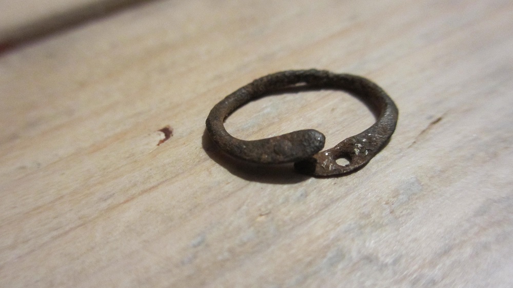

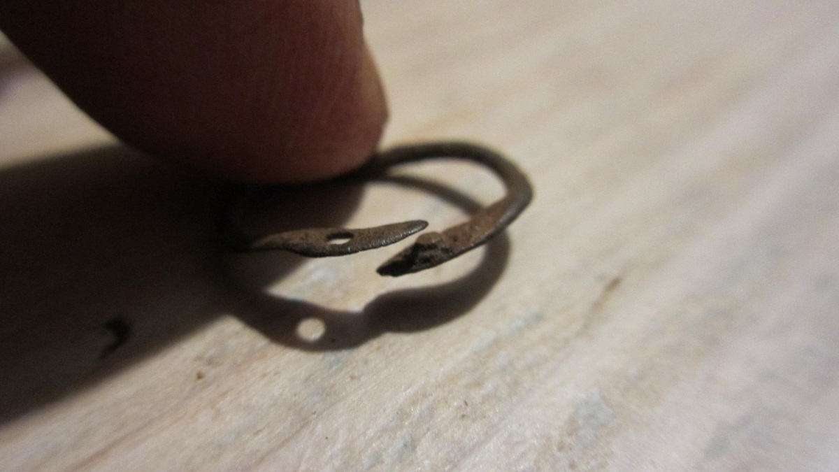

Posted: Mon 24 Feb, 2014 1:02 pm Post subject: |
Here some close up pictures from the rivets.

Mart Shearer
Posted: Mon 24 Feb, 2014 1:35 pm Post subject: |
M Hermes wrote: | I had a quick look and you are right, it is all demi riveted. Does that mean that it is made in India, the Ottoman empire or Persia? |
Most likely. Demi-riveted construction with round "pin" rivets seems to have been the norm in Europe until the mid-14th century when it appears to have been completely replaced with all riveted construction. Some sources indicate Turkish mail moved to all riveted construction in the 15th century, but Indo-Persian mail seems to have remained demi-riveted into the17th century, eventually being replaced with butted mail. Obviously finding early European mail is a more infrequent occurrence.
The third example seems to have a 90 degree joint (rows change direction) at the lower left of the photo, something usually seen in the armpit.
The second example looks like it might have some expansions at the lower edge of the lighter mail. These might be expansions over the hips, or turned around, contractions over the shoulders. Does Sample #2 have the heavier mail all along the top edge, or is this merely a false impression from the photography?
Thanks for taking such good photographs, as well as taking the time to share.
