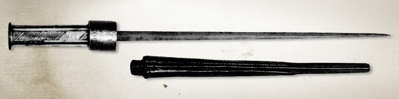

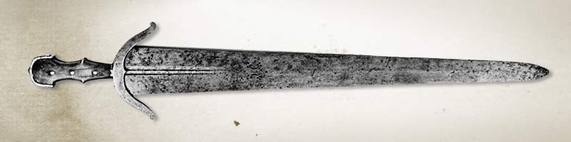

This is the sword you're speaking of, from our Type XV spotlight:
This Type XVIII has a grip of black horn. Its cross may be more recent, which could cast doubt on its grip too:
This Type XXII has a grip of horn also:
This is not exactly a sword, but the middle Scottish dirk in this picture has a grip made of horn:
It seems to have been a using weapon. We see knife grips of horn and antler often enough that they must have some strength. I'm actually having this dirk recreated. Happy
This rondel dagger has a grip of horn:
These all seem to have been left bare on purpose.

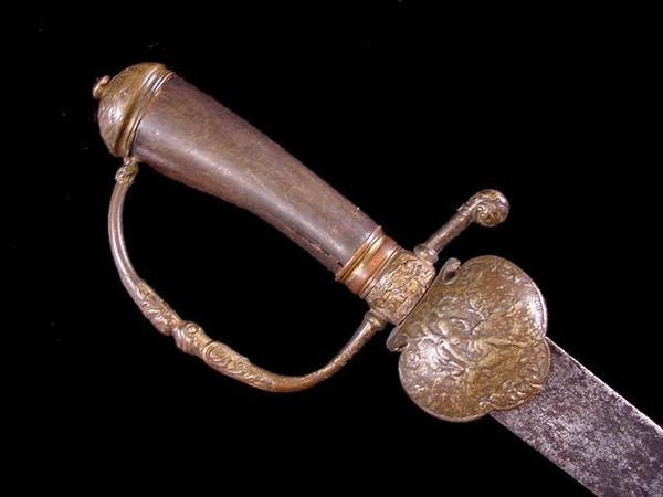

I have also seen horn grips on a lot of antique hunting swords/hangers.
 Attachment: 23.97 KB
18th Century Continental Hunting Sword with horn grip
