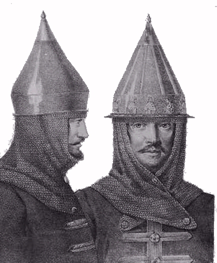

Hi
I can not verify the authenticity of the style of coif? or aventail shown in this pic. Late rus warriors, the one with the open coif/aventail is wearing a byzantine style helmet (the original helmet from memory has no holes to house a aventail).
This is a artists impression, could be completely wrong.
hope it helps, or gives direction.

Images of Rus warriors in secondary sources show open-necked coifs everywhere, usually pinned just under the chin and the two ends left dangling upon the chest--not even fastened like the illustration above. I'm not so sure about the primary sources, though.
