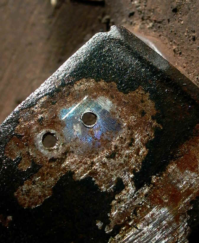

I am only posting this shot because its the only one I have seen like it. After the Victorians finished scrubbing all the original finishes off harnesses and making them nice and shiny for the public to see, occasionally people find a hint of the original bluing ( or browning, etc ) like in this rare photo. Some of you would have seen it before...it might be already here somewhere........but for those who havent seen it.......it must have looked quite dazzeling to see the whole (Anime) "Peacock-Blue" breastplate when new !!
Here's the link also.............. http://www.masterarmourer.com/anime_breastplate.htm

A few years back alot of the armour I made I began to either blue or black. it does looks nice. We had a bright suit that was identical to a black one I worked on from teh 1610's. Same in every respect but color. I assume that the one had its paint stripped. Interesting though.
That would be a nice color on the piece for sure.

The original blueing looks even more majestic than the new version, in my opinion. What a sight the original, as new, must have been...

Indeed........anyone know how it was done ? I believe a formula was used in the quench ? Might be completely wrong here though ? Anyone doing this today ?

It's hard to judge from pictures on a computer because monitors and other things will vary somewhat, but you can get a color a lot like this just by heating steel to approx. 600 deg. F. Different colors of oxidation appear on the surface of the steel as a result of heat. The violet color that you can see at the edge of the blue occurs at a slightly lower temp.
At red heat a heavier scale begins to form that is bluish-black.
Good temp. control can produce some interesting colors.
