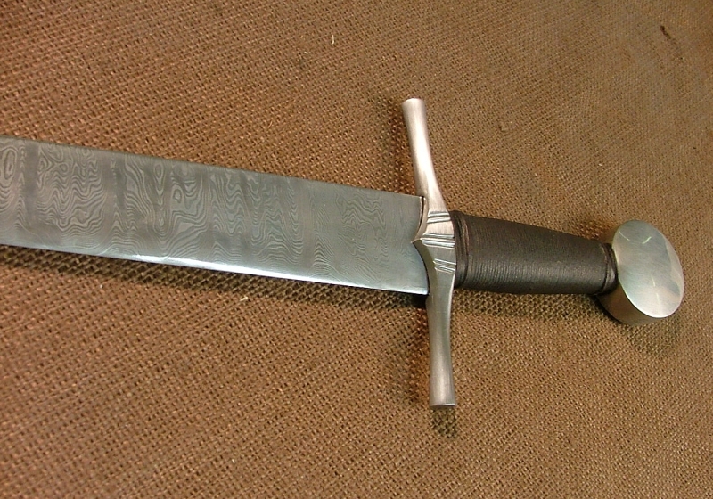

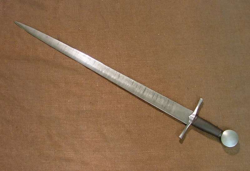

14th Century English Short Sword (Single Edged)
This is inspired from an unusual but interesting 14th century, single edged, short sword from the Royal Armoury in Leeds.
I made this piece in pattern-weld to add to the piece. The pattern-weld is flawless and is 180 layers of L6 and 1095. This blade is really tough.
I am nearly done with the scabbard. I still have to forge the chape. It will be a nicely decorated leather covered wood core with a 14th century chape.
Here are some of the stats:
Steel: L6 and 1095, 180 layers
Weight: 2 pounds (0.907 kilos)
Blade: 23.23” (59.0 cm)
Overall: 28.8” (73.2 cm)
Grip Color: Dark Brown
This piece is sold. If you are interested in a similar piece, contact me at ericmycue@verizon.net to set up a custom order.

Beautiful piece of work.
What is the blade cross section? The pattern welding makes it very difficult to judge the contours of the surface.
It is has a wedged shaped cross-section.

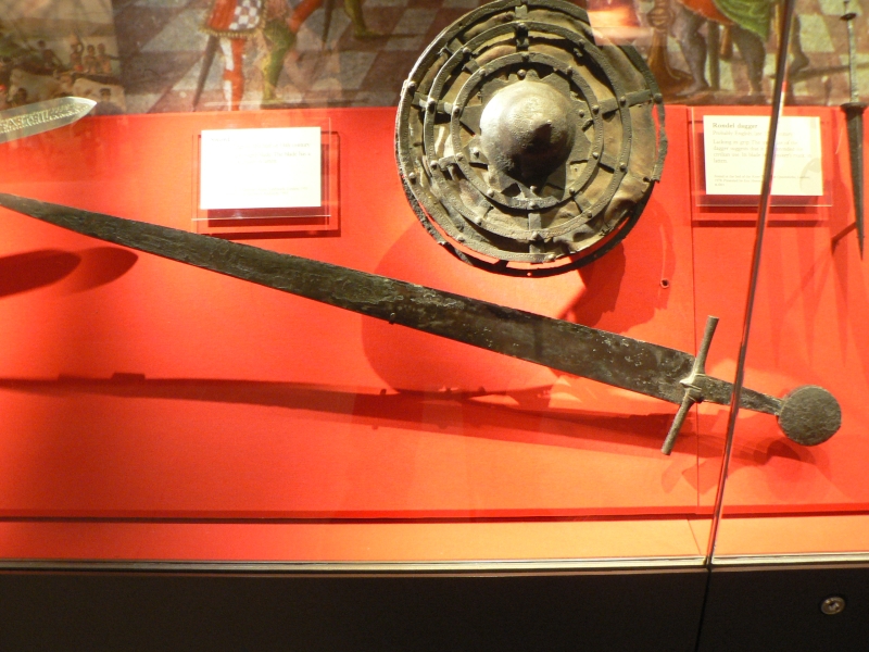

That's an interesting original you based it on. I've never seen it before. Is it in any print resources? One thing's for sure, it proves that medieval sword smiths often produced weapons that are "off the beaten path" as it were. Do you suppose it is some sort of early "riding sword"? Or could it be a very precocious hunting sword? Or an aberrant falchion? (Don't mind me, just pondering the unusual qualities of this sword.)
It appears in a few publications. I think one of them is European Swords and Daggers in the Tower of London which is out of print. It is an odd ball sword for the 14th century. I'm not sure what documentation the Royal Armoury has that supports the 14th century date. Just my opinion: I think it is a 15th century weapon...no support just a feeling. It could be a riding sword, or an early "English-style" messer....again not sure. You do see these swords that have a "double-edged" profile but are single-edged weapons.
Anyway, it is definately a different sort of sword. This was just and "inspired by" piece and not an exact reproduction. :-)
Eric,
You may be right about the date. Something looked familiar about the cross, and then I remembered that the decorative engraving in the centre of the cross looks roughly similar to that on the cross of the large-bladed type XVIII that Oakeshott showed as type XVIII. 10 in Records of the Medieval Sword. The cross on the sword in Records is a bit more elegant, with knobbed and notched ends, but it shows the same three groups of "lines" in roughly the same pattern. Oakeshott dated that sword as circa 1400-1450. (I'm also very familiar with MRL's replica of that sword, called the "Patay"; it's on the wall to my right as I type this. It's not nearly as nice as the original, of course, but it was one of their better jobs, appearance-wise anyway.)
I've also read that "cusped" ecussons are more typical of the fifteenth century, but there are plenty of earlier examples that proves this wrong. However, Oakeshott did describe a similar decorative style that this sword displays in The Sword in the Age of Chivalry. He stated that crosses with lines "girdling" the ends of the cross became popular around circa 1225 and again in the 15th century. He said that, on 15th century examples, the lines often formed chevrons and often accompanied a group of radiating lines similarly engraved on the ecusson. This design element (the groups of lines on the ecusson) was mostly found by itself on those crosses with cusped ecussons. Agin, this could point toward a 15th century date for the original.
If it is 15th century, then it can certainly be classed as a "riding sword". Of course, shorter swords were sometimes preferred by warriors throughout the medieval period. (For example: Oakeshott's X. 12, with a 26" blade, and X. 14, with a 23" blade, both from Records.)
Yeah, European Swords and Daggers in the Tower of London is out of print, but occasionally available used. It's one I don't have, and unfortunately can't justify the cost to purchase it when it does come up for sale! Some of these more in-depth sources are priced almost as much as a decent sword!
Thanks for the information! I hope I didn't just babble on about it!

Just to be a pest, where is the point of balance, and do you have any pictures looking along the back of the blade?

Eric, do you recall any info on the buckler that is with the sword in Leeds?
