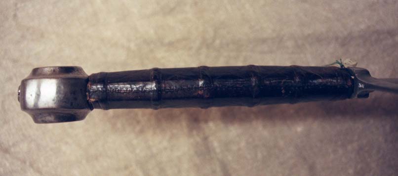

I attach a pic of an original 14th c sword (Royal Armouries, Stockholm) where you can see the seam well.

A visible seam but that's still pretty neat sewing, thanks for that.
