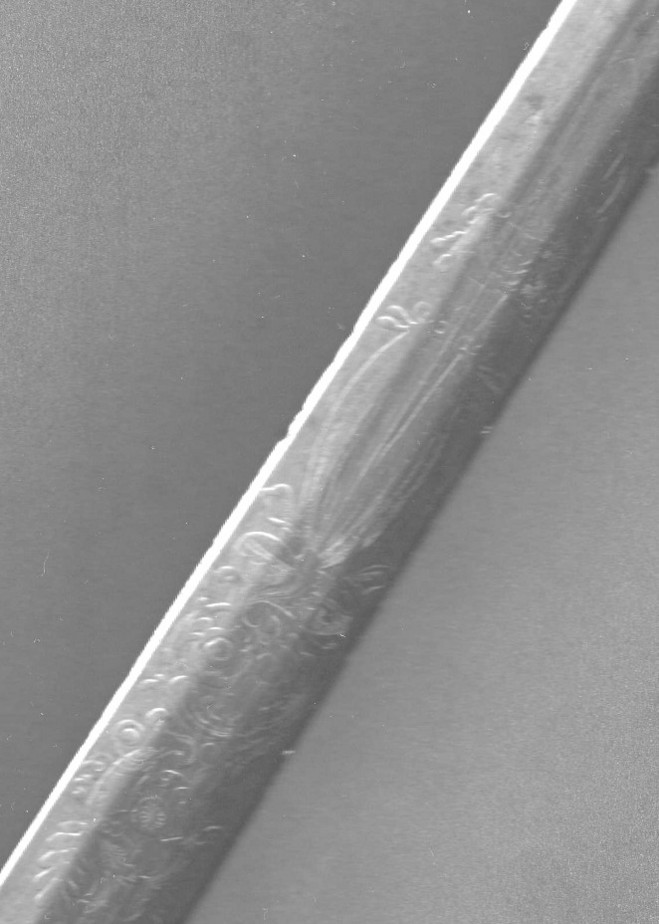

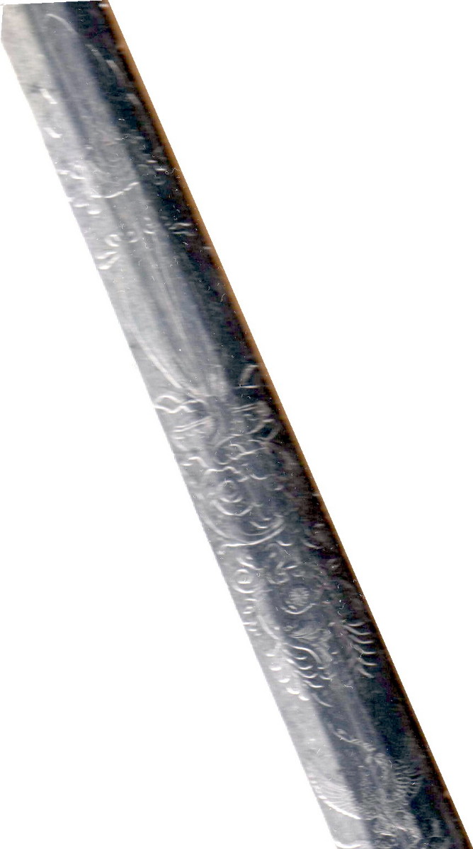

I tried to scan some images of the blade on my copier, does any one recognise the coat of arms?
Thank you
Matt
 Attachment: 94.99 KB

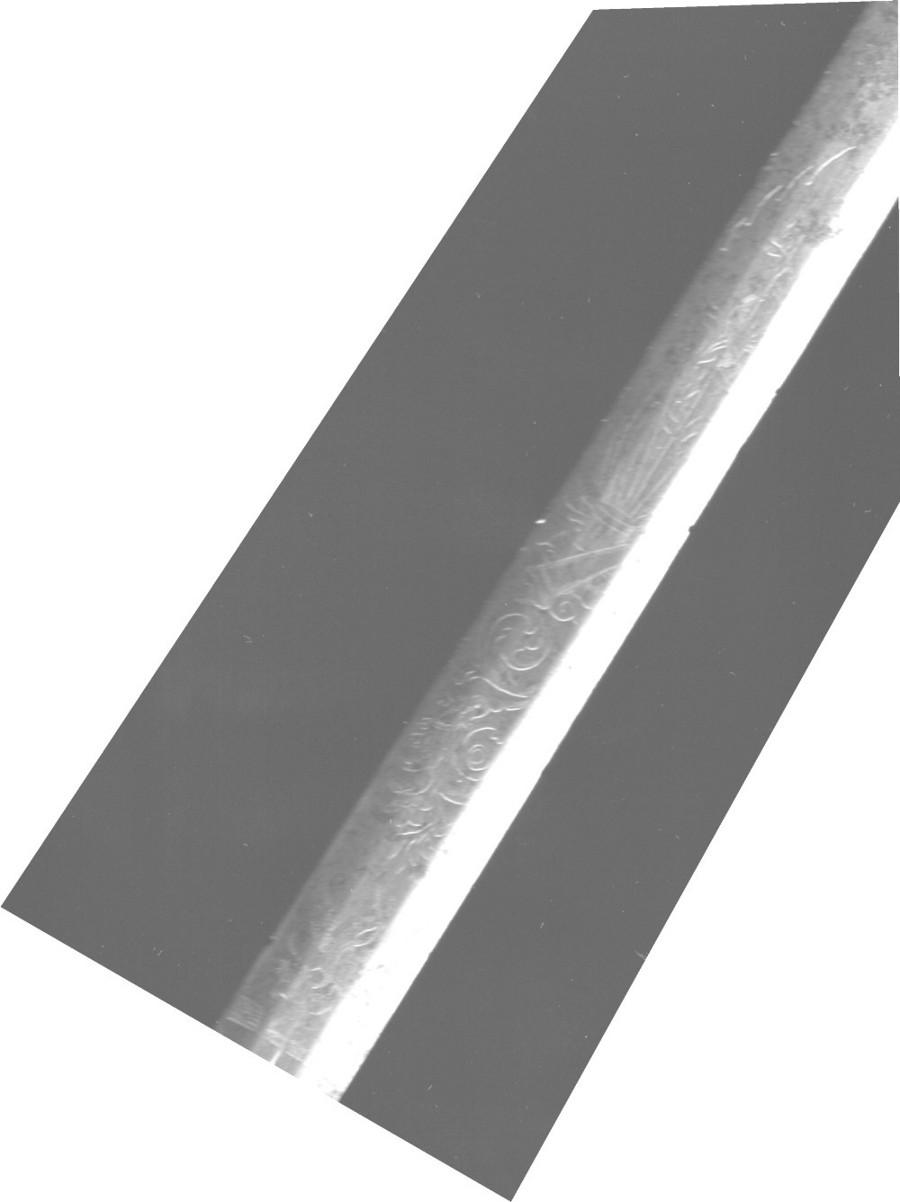

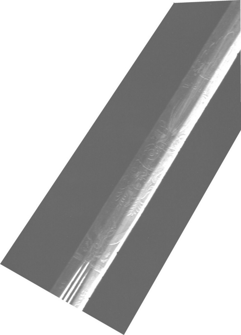

A couple more
 Attachment: 78.38 KB
 Attachment: 86.1 KB

I really can't make that out very well. Is there a chance that you could do a drawing or try to describe the arms?

There is a floral pattern above an eagle with up stretched wings and a snake in it's beak.
Above thaton on this side is a canon, a bugle and a drum, above that is a flag pole with un furled flag on the left and a floral pattern on the right.
The top of the design looks like the top of a feather.

On the other side of the blade above the eagle is another floral pattern, above that ( coming out of the floral pattern) are two jars or urns. There is a sword handle and part of the blade sticking out of each the urns.
Above that is hard to make out, it could be some material tied onto a pole and cross member, I don't think it could be a sail
It looks like the drapes you see behind politicans during news conferances...kind of.
The top again resembles the shap of a feather.
 Attachment: 62.93 KB

I'm having a difficult time making out the photos, too. Here is another version of what was posted. It might add another view, if not some clarity.
 Attachment: 32.67 KB
 Attachment: 30.18 KB

It could be purely decoration and not a coat of arms.

The eagle with a snake in it's beak is the usual decoration found on Mexican military blades , most often on the guard. I've seen one however with the snake etc. on the blade. W.

Looking at this with an admittedly out-of-practice heraldic eye, I can't make out anything on that which looks like actual armory, it just looks like decoration. None of it appears to be organised in a fashion consistent with heraldic art.

I have to agree with both of the ideas mentioned above. It doesn't sound like a true coat of arms, and the eagle/snake combo makes me think it is probably of mexican origin.

Thats not a coat of arms, its just decoration. Typically a coat would never be depicted on a blade anyways. However, sometimes swords would have devices form their owners coat etched on them. But by the standard definition this is not a coat of arms. You could however search for families that have an eagle clutching a serpent displayed promonatly on thier coat.

I've been looking at your photos both here and on SFI, and something's been tickling away in the back of my brain, and I finally figured out what it was. I think what you've got there is an old Espada Ancha or Spanish Cavalry broadsword blade from the 1700s that has been rehilted in the 1800s and etched at that time to reflect current politics. The blade type (broadsword with the 3 fullers) is very common in the 1700s on Spanish colonial and military swords, and I've seen examples of them rehilted with several different hilt types in the 1800s. Yours is the second one I've seen that has been etched with themes particular to the 1800s. The other one was on eBay maybe 5 years ago, but I unfortunately don't have any photos of it, and can't remember what the hilt was like, other than it was a typical 1800s design.

My first thoughts on this were quite similar, a Spanish dragoon blade (whether German production or not) that was rehilted.
