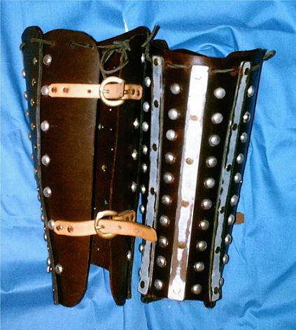

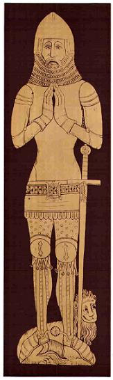

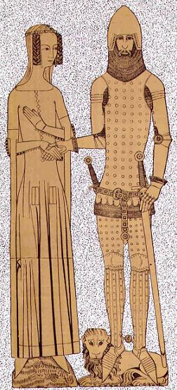

PostPosted: Wed 18 Oct, 2006 1:35 pm    Post subject: Images of splinted armour         Reply with quote
Hello all!
Okay, my wife's gonna get mad at me for doing this, since she knows how precious my books are to me (more precious than my MRL swords, certainly), but I felt that images might help the discussion. Since my copy of Henry Trivick's The Picture Book of Brasses in Gilt was already cut-up a bit by a previous owner (a couple pages were missing, presumably cut-out and used as framed art), I felt it wouldn't do too much damage cutting out a couple more. Since I have the frustrating sort of scanner that only scans single-page documents, that's what I had to do to post the pictures. That's also why I didn't post any pictures of the German effigies; I refuse to damage any more of my books!
Anyway, I managed to scan the plates from Trivick showing the de Stapleton and the Cheyne brasses. Note on the Stapleton brass the torso defence and thigh defences display rivets, but no lines. I think it's fairly safe to assume that this depicts a brigandine or coat-of-plate style of construction; overlapping plates or scales rivetted beneath a cloth (or sometimes leather, perhaps) cover. Note the lower legs are defended by strips of material rivetted to a fairly stiff backing material. The fact that the material is somewhat stiff can be deduced by how it stands up away from the foot. The leg defence can be interpreted as metal strips rivetted to leather greaves.
Note also the Cheyne brass wears similar (almost identical) defences on the lower legs. Again, it consists of strips rivetted to a backing, although the "stiffness" of the backing material is not as clearly evident as on the Stapleton brass. Again, Cheyne wears cuisses constructed just like a coat-of-plates or a brigandine coat.
Many of the German effigies depict greaves or complete armour for the limbs constructed in a very similar manner, although some don't show obvious rivets. The German effigies and sculptures do show this armour in three dimensions, something which the English brasses obviously do not. On the German sculptures and effigies, the "splints" (the rivetted strips on the English brasses) do definitely stand "proud" from the backing material.
I have also included a photo of my attempt at recreating the "studded and splinted" greaves on such effigies as Gunther von Schwarzberg. It would never be acceptable to a living history group since I was forced to use some modern materials to keep cost down, but it follows the general form. The splints are rivetted on; I used "rapid rivets" to save time and money. The "studs" are round spots from a leather retailer; if I was to make it more "authentic", I would have used disks just like that depicted on Schwarzberg's effigy, not "spots". I had the round spots readily available, so that's what I used. The greaves originally began life as full leather greaves; that's why they are in three pieces. (I originally rivetted two pieces together along one side and laced them shut on the other, but then decided that I would rather have a strap and buckle closure down the back.) I would imagine "authentic" greaves would have been made with only one piece of leather. Finally, if I was to make these again, I wouldn't use "wax-hardened leather", but that was the technique I knew about at the time. All disclaimers aside, they look generally similar to the German "studded and splinted" greaves.
A final note; I would still love to see any images of the German effigies showing "splinted" or "studded and splinted" armour posted on this thread! It might help the discussion if we had images to look at!
Stay safe!
 Attachment: 51.37 KB
Sir Miles de Stapleton and wife Joan, 1364.
 Attachment: 20.47 KB
Sir Thomas Cheyne, 1368.
 Attachment: 39.12 KB
Richard's studded and splinted greaves, back and front.
