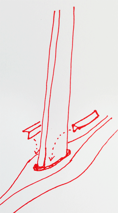

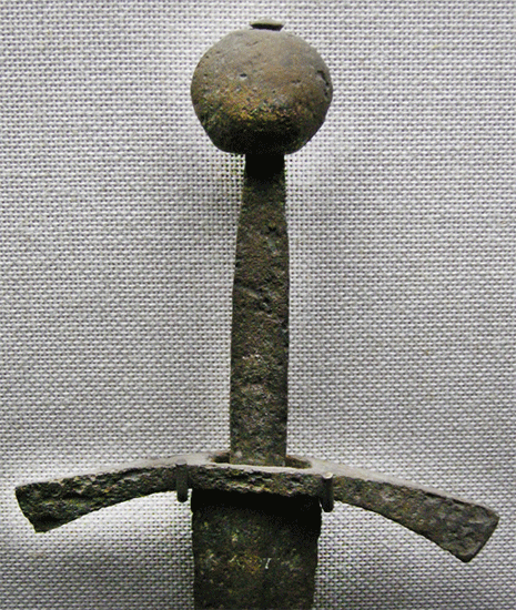

PostPosted: Fri 16 Sep, 2016 6:51 am    Post subject:         Reply with quote
Here's my method, along with a reminder that this is not a new challenge. In some cases, apparently, the lower end of the grip was carved to fit into the tang/guard gap to stabilize the fit.

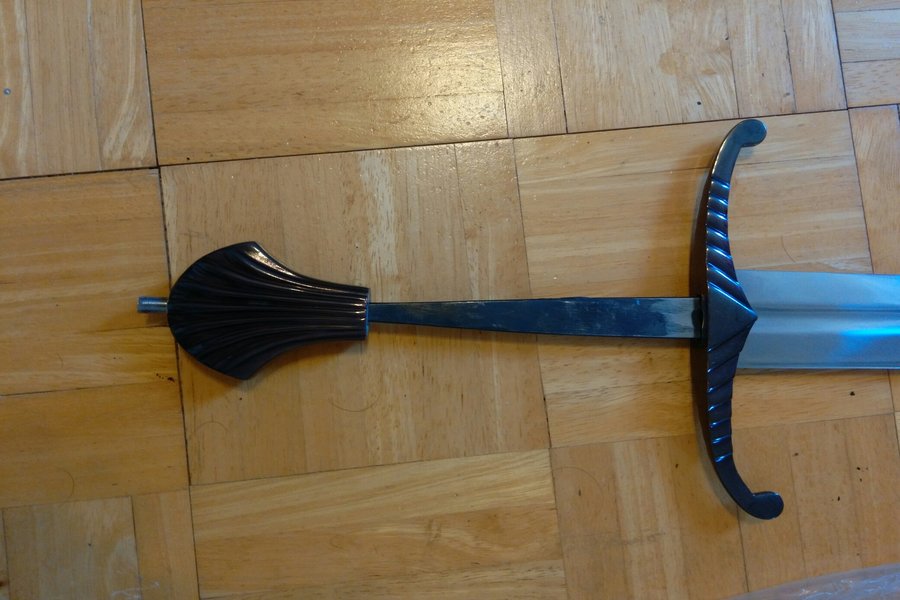

PostPosted: Sat 17 Sep, 2016 12:53 pm    Post subject:         Reply with quote
Thanks Michael and Sean, that was all very helpful information. I particularly liked your method for shimming the loose guard Sean.
I ended up removing the pommel, and I'm actually glad I did. Even after applying heat, the pommel didn't budge at all, despite having a visible gap between the tang and pommel. At this point, I assumed that tang had a strange shape and the pommel was actually somehow wedged onto the tang. So, I actually drilled out the peen(which was actually surprisingly thick for a Windlass) and applied more heat. The pommel finally came off after quite a bit of hammering on it with a rubber mallet. As it turned out, the pommel was not wedged in any way, it was only being held on by resin/glue(as a side note, I researched this a little and the glue that Windlass uses seems to be the same resin/epoxy that was historically used to attach Talwar blades to their hilts. Apparently, this method works great for close fitting single piece hilts... not so much for really loose multiple component hilts... I apologize in advance if you guys already knew this and I was just uninformed).
I'm planning to shim the guard now and wedge the pommel and repeen it. Wedging the pommel will shorten the handle by at least an inch(I'll attach a pic) but I'm actually happy with that. The original handle seemed a bit too long for a bastard sword, and having the pommel closer to the blade already makes the sword feel much more lively.

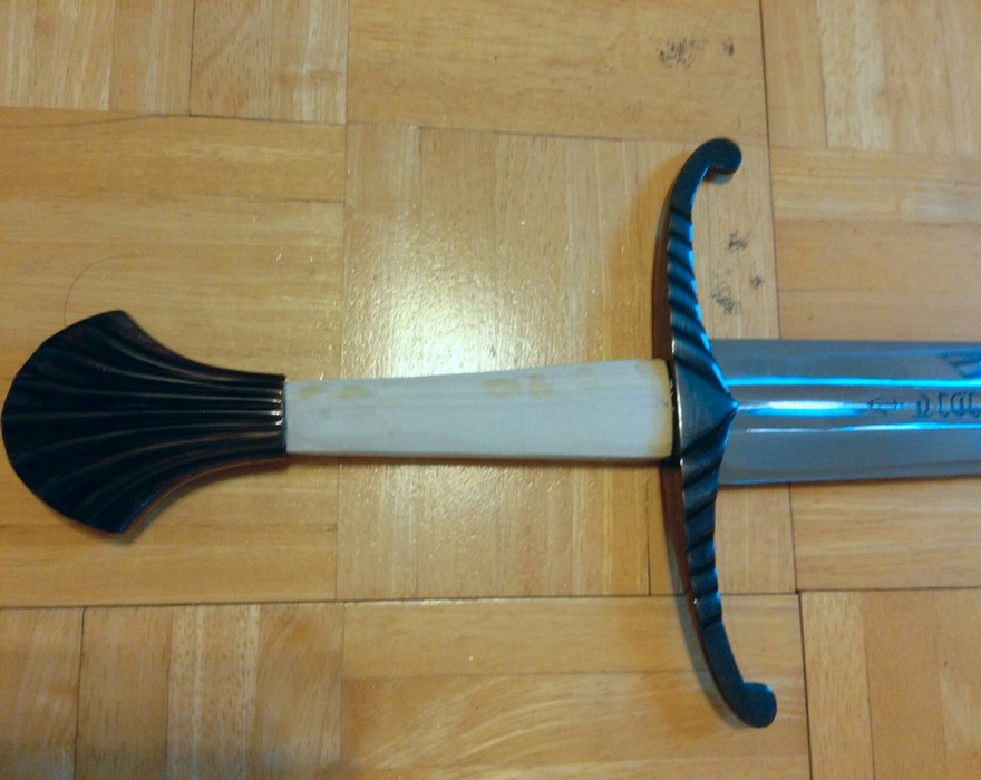

PostPosted: Fri 23 Sep, 2016 9:29 pm    Post subject:         Reply with quote
Update:
I took Sean's advice and left the sword's weight and proportions as they were, since the balance was already about 4 1/2 inches from the guard. I've since shimmed the guard, wedged and peened the pommel and sandwiched a new wood grip on the tang. I'll do the leather wrap and hopefully start the scabbard over the weekend.
 Attachment: 83.44 KB

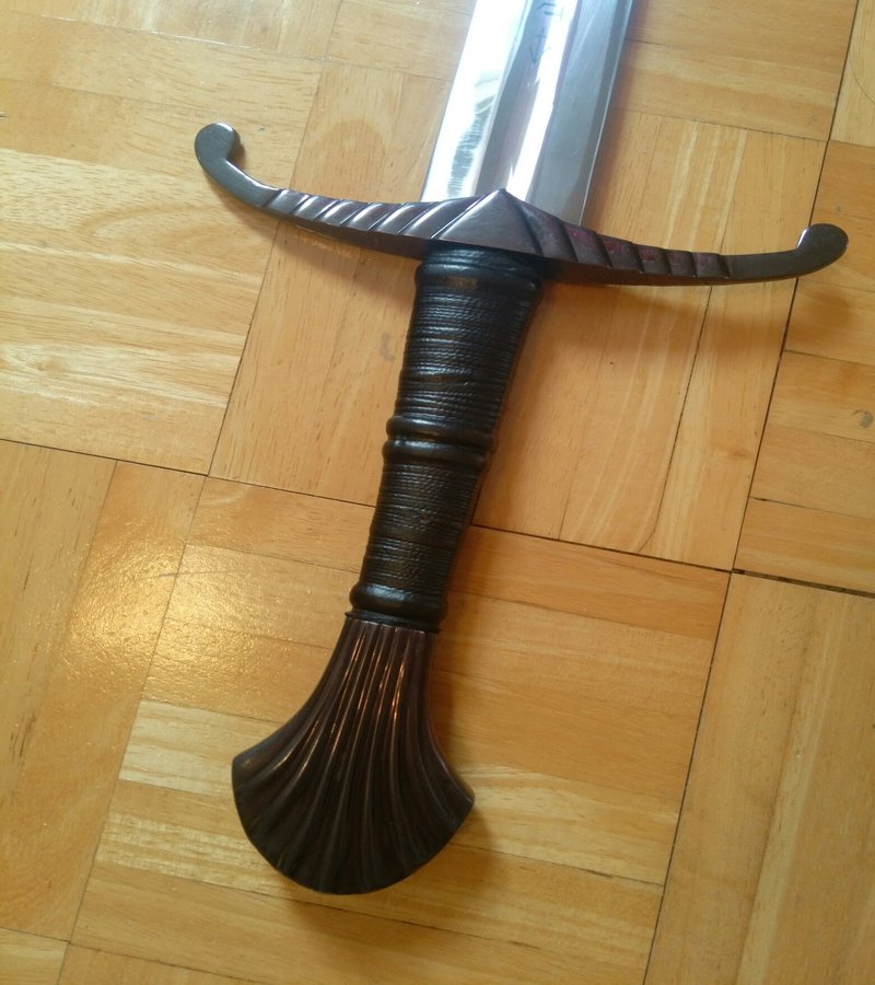

PostPosted: Sat 24 Sep, 2016 3:48 pm    Post subject:         Reply with quote
Another quick update, just finished the leather wrap.
 Attachment: 110.5 KB
