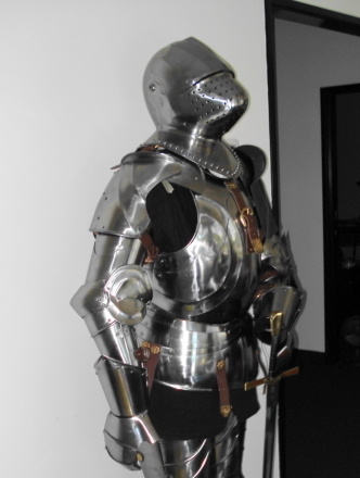

I'm 6'-0'' and 170lbs with a 32inch waist! I weighed the breast- and back-plates together, without tassets, on an expensive name-brand digital scale of 150lb capacity with accuracy in metric units to 1/10 of a gram, and the total weight came to about 19.75 lbs. This is a new scale used in a small parts manufacturing facility, and is frequently tested as such, so the accuracy should be very reliable. The average thickness looks to be about 1.2 to 1.5mm, not counting all the doubled up areas. Sorry if this information doesn't fit into your view of things, Josh.
 Attachment: 96.42 KB
