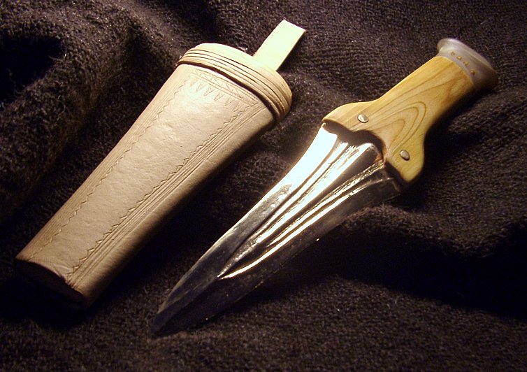

I'd like to show off one of my latest and most favourite reproductions. It's a reproduction of and Irish style bronze age dagger and scabbard. The dagger is from the period where the first daggers started to get sword lengths in Ireland and the UK (similar to this one, but stretched out greater lengths). So in that respect it belongs to the ancestors of swords in this region.
More information and photos can be found at SFI:
http://forums.swordforum.com/showthread.php?s=&threadid=72107
Attachment: 97.88 KB

Very nice! Do you have any pictures of the blade before hilt assembly?

Not of this one, but here is a photo of a blade from the same mould direct after casting:
http://1500bc.com/bronzeage/bronzes/grooved_d...2006_2.jpg
After casting, the feed, flash are removed and the blade is polished. The cutting edge is hardened by cold-working, and extra decorative lines are hammered in the first groove next to the midrib.

Nice work, Jeroen. I was curious as to what historical methods would have been used to make such moulds. Was a lost wax type method used, or were both halves just chiseled/worked out to final shape? And also, how would that bronze have been obtained back then?

In case of these daggers, the moulds were made from stone such as soapstone. So they made two flat slabs of stone (the most difficult and time consuming part!), and then carved out the shape of the dagger in mould half. The mould of a nearly identical dagger has actually been found as well. Clay mould only survive from the middle bronze age onwards, and were usually two part (sometimes with core for socketed casts), sometimes with an outer wrapping. Lost wax was probably used in the bronze age, but rarely. Instead of wax, lead was used more often for investment casting (mostly during the late bronze age).
Quote: | And also, how would that bronze have been obtained back then? |
From copper and tin ores, which occur in mountainous areas, and were either mined, or dug from the surface. The tin ore is the most difficult to find, and only occurs in a few places in Europe. The smelting process is quite similar to iron smelting, though the main difference is that the metal does melt in the process, and you get a pure metal directly from the furnace. The copper and tin you melt together, and cast into the mould.

That won't be possible, as it was part of a trade for a reproduction of a bronze age costume (on which the dagger is displayed). However, I've got several extra blades, so I can make more daggers, but I'd probably use a different combination of hilt materials.
Quote: | In general, what are the proportions of the various metals in the alloy you make ? |
Generally I aim at 10-12% tin and the rest copper, unless I know the exact composition. But early bronze age pieces are usually mostly copper, and for pieces such as socketed axes I sometimes add a small %age of lead (very rarely, as I value my health! ).
