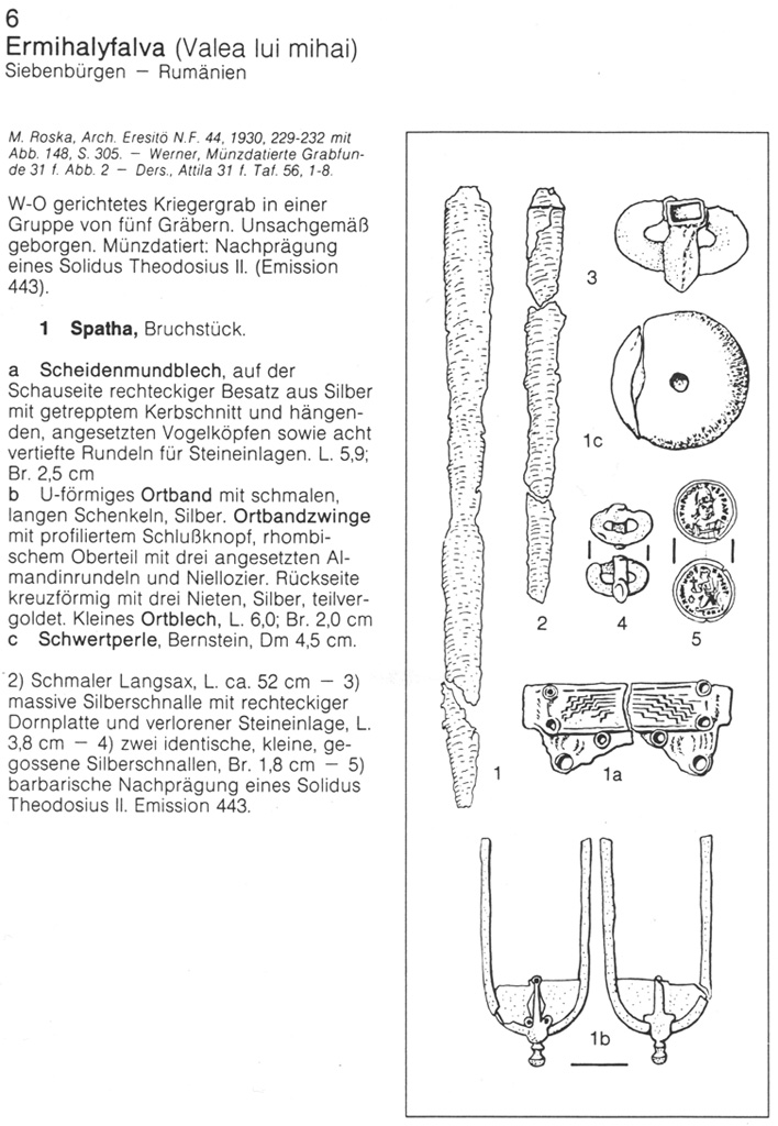

Behmer mentions this Type III sword found in Romania only in passing and does not give a find place, picture or other specifics.
However, in Menghin I found a sword from Ermihalyfalva (see attached) which I think is the one Behmer meant. Although the hilt is not preserved, the scabbard fittings fit into Behmer's type III.
This is also the only Romanian sword I could find in either Menghin or Behmer...
