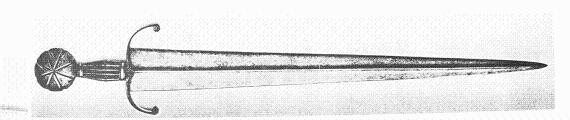

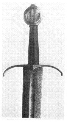

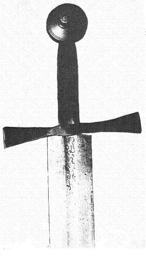

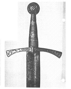

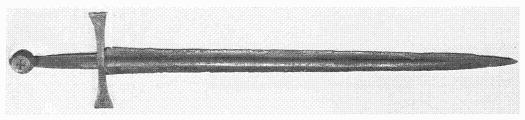

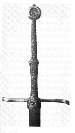

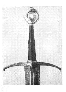

Just when you thought I was done with this topic, I thought I would post some pictures of the swords I mentioned in earlier posts. After all, a picture's worth a thousand words. Hope it's okay to use these!
 Attachment: 19.28 KB
Oakeshott Type Xa. 17 from Records of the Medieval Sword. A blade of circa 1100, and latten hilt of circa 1450.
 Attachment: 12.52 KB
Oakeshott Type X. 14 from Records of the Medieval Sword. 12th century blade with 13th century hilt of copper.
 Attachment: 20.18 KB
Oakeshott Type XII. 17 from Records of the Medieval Sword.
13th century, with hilt of gilt copper.
 Attachment: 12.81 KB
Oakeshott Type XVIII. 12 from Records of the Medieval Sword. Late 15th century, with bronze gilt hilt.
 Attachment: 18.49 KB
Oakeshott Type XVIIIa. 5 from Records of the Medieval Sword.
15th century sword with hilt of gilt bronze.
 Attachment: 8.35 KB
Oakeshott Type XXI. 1 from Records of the Medieval Sword. Sword of Cesare Borgia, 15th century with a gilt bronze hilt.
