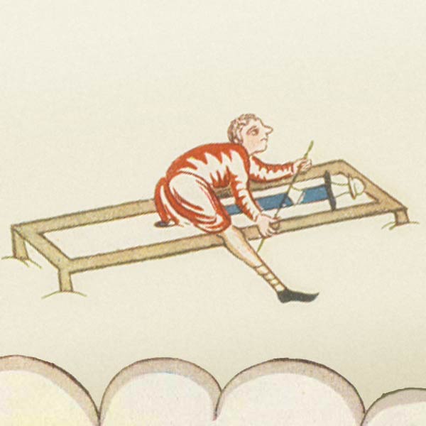

Just adding to this one, here's a picture of a similar scraper in use, (Cantebury Psalter, 1150):

that is the most useful image I have seen in years .. only: how was such tool actually made ?
Pack carburization. Basically, they wrapped the tool in some charcoal and lamb skin (contains the acids associated with carburization in modern processes.) Then covered it in clay and dried it to isolate it from air. It was then heated in a coal forge environment for several days to drive the carbon in. I have a later period (believe it is a translation from 16th century) recipe describing the process for making files capable of working metal and other hardened tools.

But I think that Bruno refers to the construction. It's basically a piece of rod with a hardened steel chisel tip, set into a bar (wood, or iron). The chisel has a large angle at the cutting edge. I'm currently still trying to figure out the most ideal angle, but you'd have to think in the 45-80 angle range. The bar is shaped such, that when the front is ground off at the right angle, the cutting edge has the shape of the groove or fuller you want to cut.

I am not sure what the real mystery with blade scrapers is. Some current day makers have web site photos of them in use. At least one asserts that it was the more common method for finishing katanas. ( I have no idea if that is really true. But I have been using similar objects in woodworking longer than I can remember. In furniture working, the wood type scrapers, Sandavick, etc. used to be marketed as a Danish invention.)

The ones I've made so far have a 90 degree cutting edge... its nice because I can flip it over and use the other side, too. I don't think the angle really matters too much, as long as it is sharp...
I believe the grooves on Japanese blades are traditionally done with a scraper, I've never seen or heard of them being forged in.
The tool illustrated is very similar to what one bladesmith I know uses, though he uses a carbide cutting piece. The next one I make will likely use a separate handle/blade setup so one handle can be used with multiple cutters.

This is a close up of the bottom left area in the illuminated manuscript.
Attachment: 176.63 KB
I have seen something similar in appearance. This was in Barta's shop on one of the articles about him. It looks geared towards one man use. I don't remember if it had a seat as similar rigs ("pony's") sometimes did for other crafts.
Attachment: 38.09 KB
The tool depicted in the illumination could also be a polishing tool: a burnishing steel set in a handle.
Note the horn set conveniently at the side of the work table: that probably holds oil, or possibly oil and fat mixed with an emery compound.
The blade the work on does not look like it has a fuller. It seems to be a narrow pointy type XV blade. Not that details like this is always very clear in illuminations, but I think that there would have been an attempt to depict a fuller would if they were using a scraper to shape one.
What I cannot understand is the red material they both hold around and under the wooden rest? Something to collect dust? Why?
I´m completely mystified.
Very nice image anyway!
My initial thoughts for the red thing (hide or textile) was that it would be a way of keeping the scraper or polisher steady.
Although I currently cannot say why I think this - time to sneak off to the workshop and see if I can work out why...
Pure guess work here, but maybe the red items were used to regulate pressure/depth of cut? Move the device forward and back until resistance decreased, then grasp the cloth/leather a bit deeper with each change, keeping a somewhat more accurate grind than by solely "eye-balling" it. That could help regulate position as well as depth.
