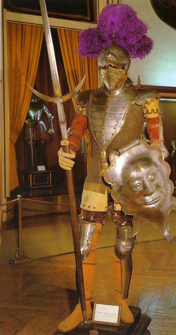

I found the attached photo on my computer, and immediately thought of this topic. Regrettably, this is one of the instances where I have neglected to note where the image came from, so I can't give further details, but this does at least prove face shields aren't just artistic license. I must confess it was the polearm, not the shield that originally convinced me to save the picture.
 Attachment: 39.74 KB
Face shield
 Attachment: 122.94 KB
Full Image. [ Download ]
Face Shields
Wow ! Thats a fantastic image....the armour looks fairly late. Could be a composite armour anyway. Two of my reference images of face shields are from c.1320 and they seem to go through at least until the late 1500's. Several of them are shown in battle but only by some men....they may have even been used as a sign of rank or some other significence.
Mr Bell
Does the label say something about Carlos (Charles?) V? If so, that would put it early to mid 16th Century I think.
Geoff
I did try and read the label but I had some difficulty working out what it said, possibly because Carlos never occured to me. The fact it appears to be in spanish doesn't help either.
Translated into english my best guess is:
ARMS Eguro? of war of Charles (Carlos) V
I have no idea what eguro means, or even if I have the right letters.

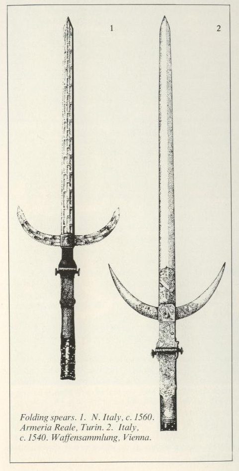

The pic of the polearm as posted by D Bell is known as a folding spear.
The Complete Encyclopedia of Arms and Weapons Edited by Leonid Tarassuk & Claude Blair
"The folding spear was a special type of spear developed in Italy in the 16th century and later found throughout Europe. The head had a conspicuously long, straight, double-edged blade, often reinforced with ribbing; at the base of the head there were two long, curved wings, with the cutting edge on the inside. The wings could be folded in toward the head, which in turn could be folded in toward the haft; and in turn the haft could be folded two or three times, which reduced the size of the weapon and made it easier to carry. This spear served as a weapon for wealthy noblemen only, not least because of the high cost of manufacture and the expensive decoration which often embellished it."
See attached pic.
Perhaps this is a clue as to the origin of the shield in the pic posted by D Bell?
D Bell, do you have any more pics of the actual spear?
