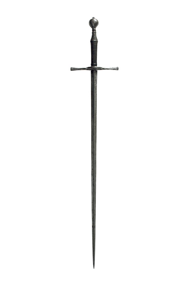

Estoc blades vary. I happen to have been collecting photos recently Big Grin
 Attachment: 15.47 KB
 Attachment: 14.57 KB
 Attachment: 6.19 KB
 Attachment: 6.61 KB
 Attachment: 12.03 KB
 Attachment: 76.99 KB
 Attachment: 83.21 KB

On the Estoc:
The one I made has a thickness of some 14-15 mm at the base.
It is inspired by those that do still have some edge: the cross section is a thich deply hollow-ground diamond section.
You can make it flex if you really want to, but it is quite stiff.
I am sure there are those historical examples that are even more stiff, especially those that have square section or those murderous ones with thick deeply hollowground triangular sectioned blades.
Rapiers rarely have blades as stout as that. Therefore most Estocs would be stiffer thant any Rapier. There are exceptions of course, but I think those are rare. There is one rapier that comes to mind that is in the Wallace Collection. Its blade is perhaps 115 cm long and has dimensions like a slim and very stout medieval thrusting sword: narrow and exceedingly thick. Not hollow ground either. It must be quite heavy, although I have never held it. I always go see it when I´m visiting, just because it is such a beast.
An Estock can have a heavier blade than a Rapier and still be very agile and nimble, becuase of the longer grip. Many estock are not that heavy, however. I also think quite a few have blades that are not much heavier than a really stout rapier blades. Those very thick ones can be made light by deep hollow grinding. Many are just flat diamond, triangular or square in section.
Personally I enjoy the hollow ground ones. They are nasty.
Historicaly the name "Estoc", "Stocco" was used to define a thrusting sword. It is not unreasonable to think that any sword with strong thrusting capabilities could have been called Estoc, Tuck or Stocco. In italian today, 15th C XVa swords are named "Stocco".
Otherwise the name Estoc has perhaps today become more specific with a more narrow definition. I think the contemporary collector definition is a long sword with long grip that has a blade made exclusively for thrusting, often lacking a sharp edge.
They do come with more variation than that however.
Their feel could perhaps be described as two handed rapiers, if that can be concieved.
You can tell just by hefting them that they would be quick and aggressive fencing weapons.
It is no great mystery that the Estoc and the Rapier were developed at the same time, although the Rapier survived the estoc in years and popularity by far.
As most sword enthusiasts today mostly look at the cutting aspect of swords, the Estoc does generally not get the appreciation it deserves. I like them and well made exaples are formidable swords with a very special character.
