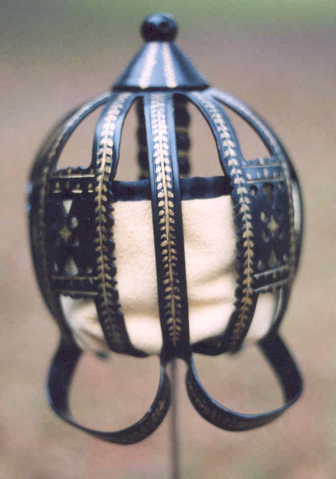

Since we've been on the subject lately, I thought I'd post this, my first "project" sword. I've moved on and done better work on more historically accurate pieces, but it was an interesting project. I'm selling this one so it's a good time to declare it finished. The photos with the chamois liner and brass wire wrap are the most recent.

Two more photos. FYI-This was an MRL "Culloden". I changed the blade cross section below the fullers from flattened diamond to more lenticular, rounded the point a bit, sharpened blade, antiqued and later restored blade, sanded awful nickel finish of basket to satin, removed blatantly incorrect solid wrist gaurd, japanned and gilded hilt with reference to an original mid-17th c. mortuary sword, and hand-sewed a chamois liner with black ribbon border. Do you reckon that foliate gilding took me awhile to do???? It was fun and I learned a tremendous amount by researching the changes, but I'm going to try to make room for some new projects.

Hey Sean, wonderful job on making your MRL piece look better! The chamois liner looks really nice, as does your japanning and gilding. Not a bad bit of work for a $160 or so sword. Any other plans for this, or another of MRL's pieces?

Thanks! The second piece I worked on, MRL's Scottish backsword, looks outstanding. I antiqued that one and will post some photos here when I get a chance to take some. The MRL falchion I reviewed for myArmoury.com is coming along nicely (at this point all I'm doing is watching it sit on a shelf and get darker and rustier). It's surprising how the finishes of the antiqued pieces mellow over a few months. You can see the state of the falchion's patina just after the last cleaning (summer) by viewing this image- http://www.myArmoury.com/view.html?reviews/mrl_falc_c.jpg
Interestingly, I think the backsword has the most convincing patina because I used a couple of different solutions on it (vinegar/salt and raw crushed grapes). The stains and pits have no real pattern or uniformity. Indecision helped, too, because I redid the grip several times so the staining is very dark, with some scratches and dents and tiny traces of leather remaining. My next project is to antique one of those nifty little Prussian hangers MRL is selling for around $95. May do some reworking of the knucklebow, abuse and antiquing of the brass and antiquing of the blade. Judging from the look of surviving specimens, I think the results could be very convincing. I'd like to do the same with a Confederate infantry sword. I'm trying to focus my collection/attention on military/infantry weapons, which is another reason I'm trying to sell the basket hilt.

That's some beautiful work! Happy
What do you mean by "japanned"? I some references to it recently, but I'm not quite sure what it means. Is it a type of blueing or is it lacquer?

Thanks! In this case, it was whatever I happened to have lying around the garage! Technically, "Japanning" was the process of covering metal with black lacquer mainly to protect the steel. It also serves as a nice ground for gilding, of course. As I recall, this was a very practical finish more likely to be used on plain military weapons and items such as military shoe buckles (one of which served as my guide for getting this finish to look right). I've heard different info about the contents of the historical lacquer. One source I read suggested that it consisted of pitch and lamp black. Not having any pitch or lamp black handy (nor being willing to go all-out for an historically accurate finish for an historcally inaccurate replica) I used 2 layers of flat black enamel spray paint followed by a couple of layers of clear minwax hard sealant designed for wooden floors. The result was a bit too glossy compared to authentic japanned items so I lightly ran some fine steel wool over everything and was extremely pleased with the results. The gold enamel paint sits atop all, and is unprotected. Original japanning is very fragile and rarely survives. If you search over at SFI you'll find more discussion about modern authentic japanning experiments.
