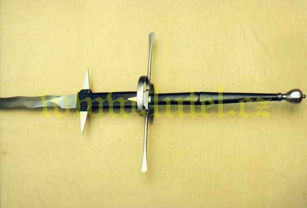

Hi, all
Lutel has something they call a "wavy" blade on a couple of their two-handers. It appears that the blade itself actually has the general shape of waves close to the quillon block. Their pictures do not show how far these waves go down the blade.
Not knowing much about medieval two-handers I ask: is this historic in any way? It's a bit surprising to me if swords of the 16th century had such a hard-to-produce feature, but I'm no expert. Wouldn't this weaken the sword?
Comments or clarifications appreciated, thanks,
Borger
 Attachment: 45.85 KB

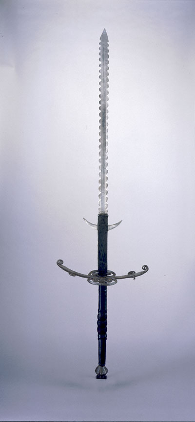

PostPosted: Fri 12 Dec, 2003 9:09 pm    Post subject:         Reply with quote
Here's some from the St. Louis art museum.
 Attachment: 12.94 KB

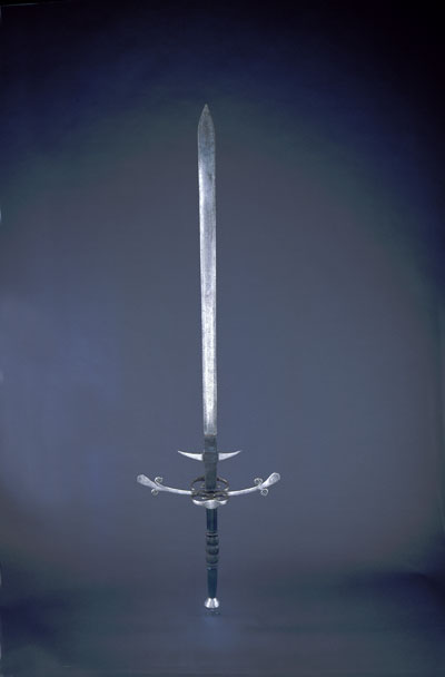

PostPosted: Fri 12 Dec, 2003 9:10 pm    Post subject:         Reply with quote
And the other, a little more applicable to this post....
 Attachment: 25.89 KB

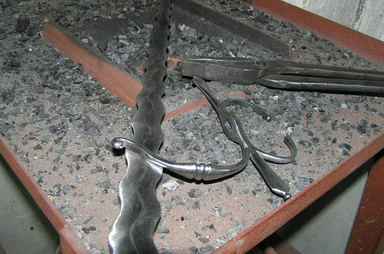

PostPosted: Sat 06 Jan, 2007 10:53 am    Post subject:         Reply with quote
It is good to see this thread resurrected... But before I noticed, for just a moment, I thought Bjorn was back Worried
It is interesting to me to see several threads on the Flamberge blade because, Lord willing, my next sword will have such a blade.
ks
 Attachment: 93.82 KB
