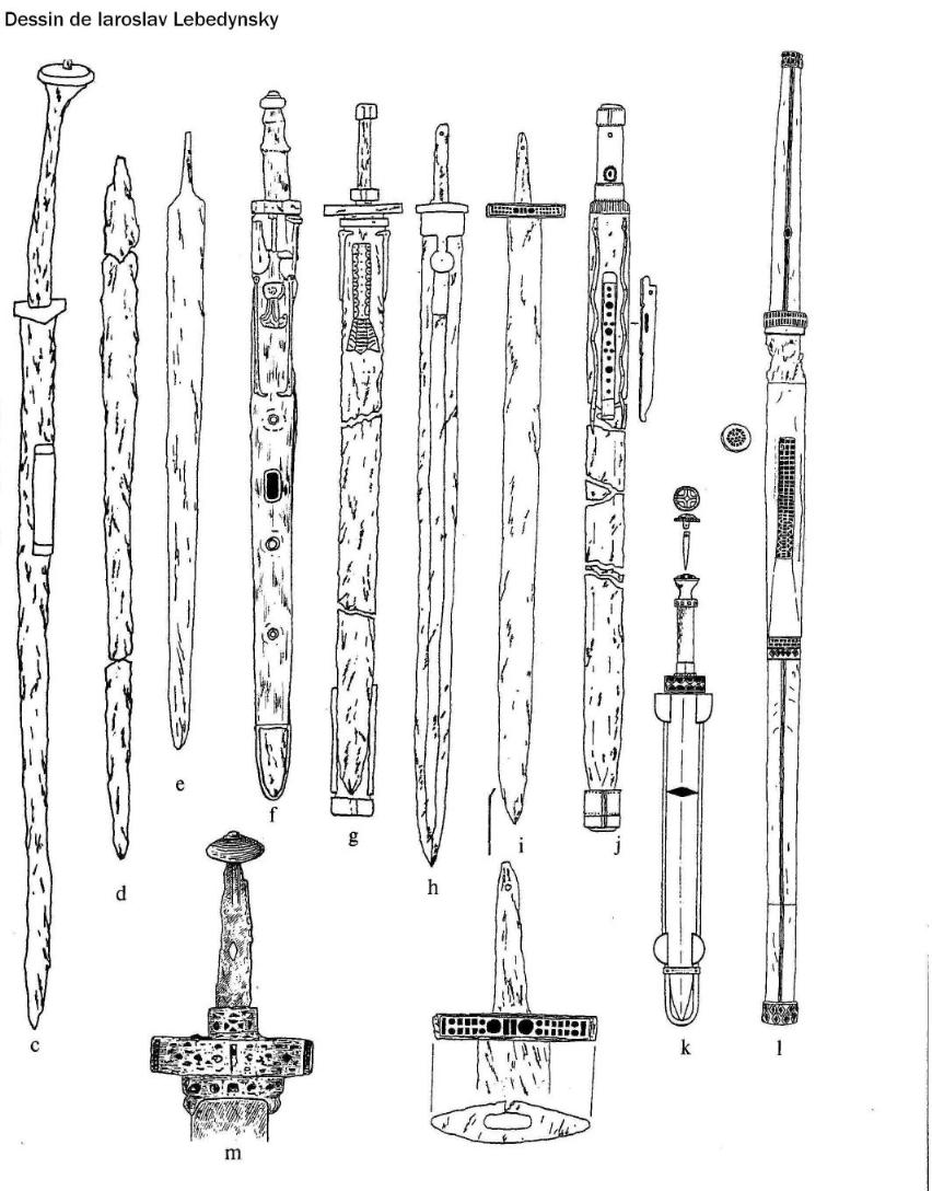

Thank you with all for your answers here a drawing for the famous sword (all on the right). I point out that his handle measures 34cm, that is to say 13,38 inches!
Attachment: 122.21 KB

Well, I will do what I can. I speak very badly English.
The blade is completely rusted. There remains only the trimming because it is out of gold.
It is the sword of a Alain lord. It was thus a heavy rider (it is certain!). The Alain heads carried armours made up of scales, the "cataphractes"...
Do we know ANYTHING about blade lenght? Just because it does look like a simplified Indian twohander... which would mean that I have another crazy theory proved. :D

Based on the photo, and knowing the grip is 34 cm, the blade would be around 75-78 cm. That is a blade length you could find on a longbladed spatha.
The gold disc and small buckle makes me think the sword was carried from a baldrick. The long row of closionet garnets could possibly decorate the slot where the cross binding for the thongs from the baldric would be attached. This is the typical method to carry a spatha.
In all, this is not a very long sword and that is also in line with those long gripped spathas you can see depicted in art, although those depictions belong to the previous century.
