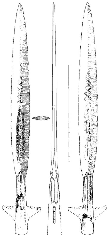

Peter Johnsson
Location: Storvreta, Sweden
Joined: 27 Aug 2003
Posts: 1,757
PostPosted: Fri 13 Jan, 2006 5:09 am    Post subject:         Reply with quote
These winged spearheads are usually given Frankish origin. I think we talk about 8th or 9th C.
Jaap Ypey has made a documentation and analysis of such a spearhed. The drawing I post here is taken from Sachse´s "Damascus Steel"
Fine craftsmanship and fairly complex construction...
You get an idea of the size from the measured line in the drawing. The units are cm.
 Attachment: 74.88 KB

J. Ypey's article "Flügellanzen in niederländischen Sammlungen" illustrates 35 of these spears, with find location, measurements and sometimes weights. It's a great stroll though the variations encountered in size, shape and proportions on these 'winged lances'.

I was hoping that someone might have some infomation on the size of the spearhead
That exact one I cannot say, but this type of spear point typically was between 40 and 50 cm. Some were smaller, 30 - 40 cm, a few larger, up to and beyond 60 cm, they were not made to a standard size.
