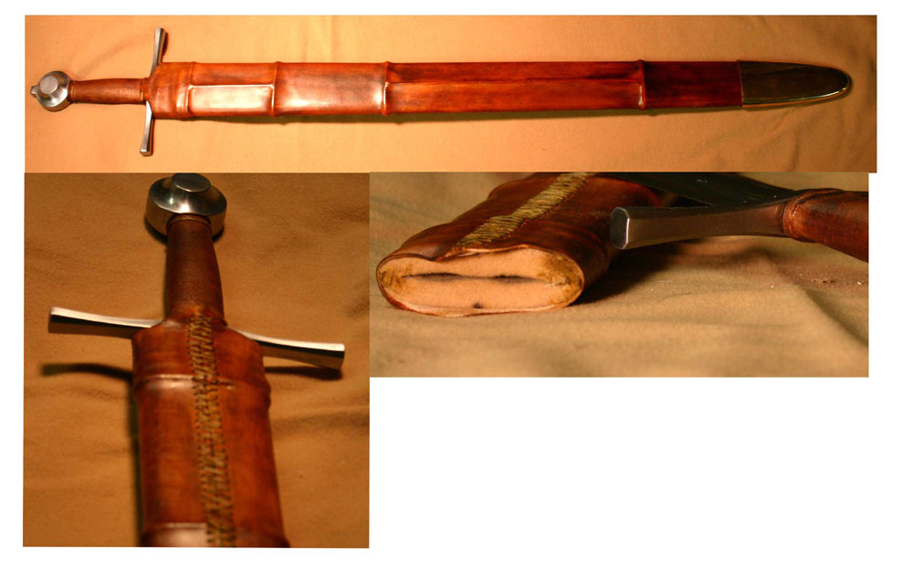

Thanks to some help and inspiration from Aaron (tips on covering) and Patrick (review of the Knight which resulted in his buying it if I remember right), I could not pass up on buying the Albion Knight during the post holiday sale. I decided to make a more traditional looking wool lined scabbard (although it has been epoxy fiberglass laminated and did withstand a 200 lb proof test of standing on the middle while only supported at the tips.)
There were many firsts in this project; attempting antiquing with leather dyes, criss crossed stitching (over 30 feet of waxed linen thread to my surprise), and cord risers that I decided to try after Rod Walker's Towton Sword Scabbard post. http://www.myArmoury.com/talk/viewtopic.php?t=5835
The risers are not particularly well placed as I planned on a simple lace up bracer to fix it to a generic belt. More than anything, I wanted something more appropriate than the shipping box to store it in.

PostPosted: Wed 08 Feb, 2006 4:08 pm    Post subject:         Reply with quote
Jared,
That's pretty good for a first attempt. Pretty darn good. Happy For future versions, consider thinning the core out. The problem with many modern scabbards is that they are just too bulky: the wood is usually too thick.

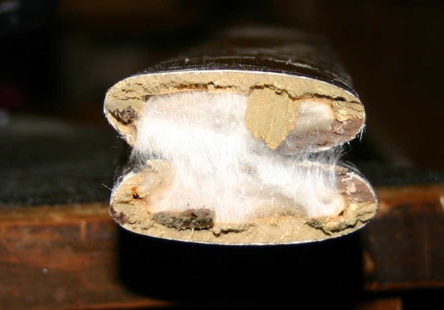

I would like to know what the forum considers appropriate thickness. I have never seen one of the better professional artisan scabbards.
I made the wood core about 3/16" (say 5 mm) thick, plus accomodated about 1/16" (1.5 mm) for the internal wool in the compressed state . The 1/8" thick wool (turned down and sewn like a sock cuff) adds the appearance of it being much greater than this around the mouth. The leather steps down where the wool cuff ends. I was tempted to cord wrap the leather at the wool, but did not foresee this possibility and used too much epoxy (soaking into and stiffening the wool) when I turned the wool sock down. Lamination adds about 1 mm to the whole core (shark and stingray skin lamination was authentic in some eastern scabbards) while strengthening it by a factor between 2 to 3 times in terms of breaking strength when standing on the flat of the middle.
I used an Albion "Moat Sale" chape. I have several of these in different styles. All of the ones I recieved (large and small sizes, pointy to rounded) seemed to indicate greater thickness near the chape area than I expected (generally at least 10 mm thick inside the chape. I actually made the core wider and thicker at the tip than I wanted, just to accommodate a slip fit (epoxy) with the pre-made chape.

The difference in perspectives here is humourous. I was not even thinking about bodily protection when working on scabbard strength.
I had read in posts at other forums that people had sometimes accidentally broken their reproduction scabbards while sitting down. I am not sure, but believe one person mentioned slamming one in a vehicle door and breaking it. The use of basswood (a soft carving wood that is not quite as light as balsa) for the core was at least part of the cause in some of these incidents.
My objective was really just to make a compact core that could flex or bend an amount roughly comparable to what the sword blade it self is capable of bending under moderate incidental accidents such as sitting or trapping against an obstacle. It is probably "over designed". A secondary benefit is that if I have unkowingly sanded excessively thin anywhere, it is well reinforced by a glue laminated covering which is very water proof. Such a covering adds negligible thickness and weight. It is simply not detectable on a finished scabbard, other than the additional strength. Of all the steps I have tried to learn in making a scabbard, the process of applying a fabric lamination over the core is by far the easiest. I would describe the lamination effort as trivial (it does add 1 day of time) compared to shaping a core nicely, getting a very compact wool lining, or taking on leather working.
The first one I tested to destruction is shown in the attached image. I was actually jumping on this one like a spring board, and got to a height of around 2 feet before landing on itthree times when it finally broke. This had 1/4" of wood all around the blade, and actually had two very thin layers of laminated fiberglass. Most of the white you see is cotton felt that was inside as a liner. If you look closely at the broken edges, you probably can see the lamination. This really seemed like more strength than necessary. I have since settled on 3/16" thick wood all around and one layer of lamination. I can not jump on that, but can stand on it.

Your scabbard looks pretty good. My only question is this: are you supposed to leave the wood at the throat opened like that?

Thanks Addison.
I felt like it actually showed some promise. Lack of thought towards suspension is a major negative, but I have not even gotten a buckle or started thinking through the making of belt yet. I have no mail, plate or kit of any type to wear it with yet. It is primarily a storage and transport scabbard that I expect to prevent rust, and hold the sword securely if I take it anywhere.
There is no visible wood anywhere. What you may be looking at is wool felt (woven felt, not just crushed) that is dyed in "camel hair" color. This felt lines all of the scabbard interior (not sewn, just glued in as two halfs to minimize additional width/ space that a fully stiched socks did add in earlier trials), and is then turned down like a pant or sock cuff over the first 2" of the scabbard exterior. The idea to turn it down over the exterior was volunteered by another forum member when I described difficulties with the wool lining tending to pull loose if left flush with the mouth. With the downturned cuff method, the wool lining stays put. The guard of the sword seats on this wool felt. All wool is now seasoned with gun oil such that if you thoroughly wipe the blade dry with an absorbant paper towel and then insert it into the scabbard, it will have a very slight oil film on it when removed. Wool is a hollow fiber that if seasoned with oil when dry will tend to repel minor moisture from humidity or light fog and retain the oil. I am not willing to go as far as throwing the thing into a lake though......

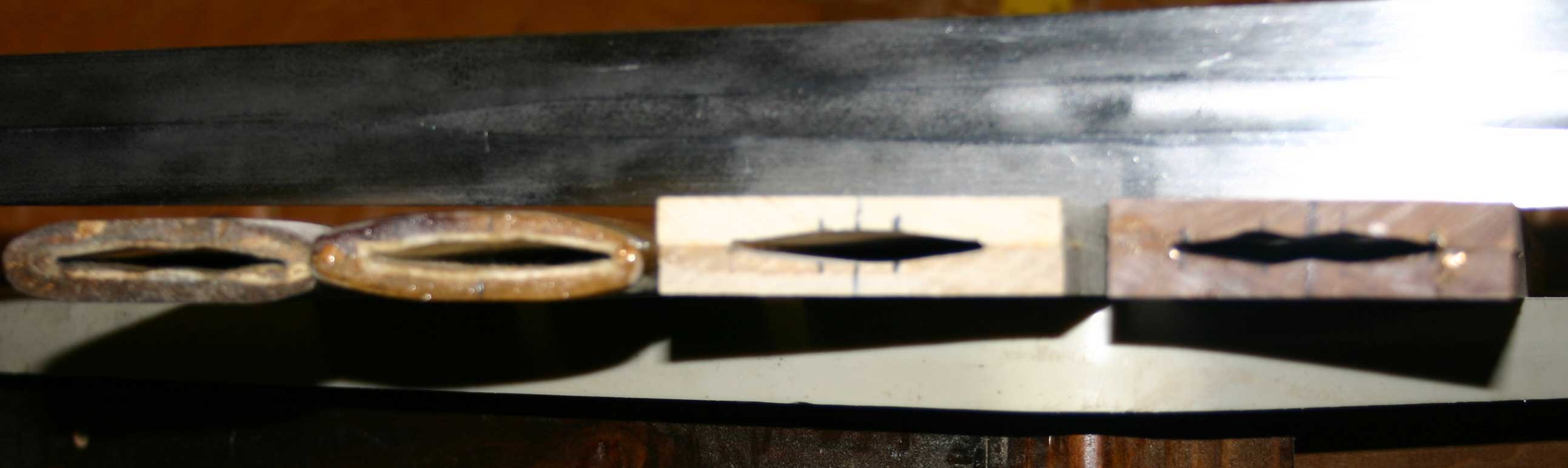

I have a experimented for about 9 months now with another wool lined core and found that the blade of my Albion Crecy blade never shows rust or patina upon removal from a "seasoned wool" lined scabbard regardless of how carelessly I put it away. In contrast, the Crecey's pommel tends to always have some rust and I have not been able to retard it even with cheap cold bluing treatments and a monthly oiling. I had some issues with the Crecey blade if it was stored in a bare wood core. It then needed regular oiling. I suspect blades typically get handled and touched less than pommels and guards though, because corrosion on the blade was never as big a problem as it has been on the pommel and guard.
A couple of wool lined trials for the Crecy and some unlined cores I had posted previously are shown below. These were all destroyed through load testing, I actually destroyed my last one (core number 9 or 10 would be my best guess) about 2 weeks ago at the point where I decided that 3/16" of wood is enough for just about anyones' standard of strength. You would fall down if anything hit it hard enough to break it while you were wearing it (true for laminated, not unlaminated.)
One more point. You may notice from the various openings that I had to really work with a partially fullered sword like the 1 st generation Crecey to get smooth entry withdrawl. If somebody formed fiberglass over it, they would discover what I stumbled into. The sword could not be withdrawn. This is because the thickest point along the centerline of the blade occurs where the fuller ends. Undoubtedly there are other blade geometries that are similar. The Knight sword was tremendously easy (full length fuller) to shape the core for, and I would expect full length diamond profiles (Albion Talhoffer, Ringeck, etc.) to be similarly easy to shape a core for.

PostPosted: Tue 14 Feb, 2006 7:35 pm    Post subject:         Reply with quote
Addison,
If you're talking about the scabbard I posted (and I would guess you are since you were quoting my text), the scabbard was completely uncovered in those pics. That's been changed. But, most of my scabbards have a bit of uncovered wood at the top: 2 Albion Campaign Scabbards, a scabbard by Aaron, and one by Jesse Bailey.
PostPosted: Tue 14 Feb, 2006 7:38 pm    Post subject:         Reply with quote
If you notice on that core I posted, Aaron followed what Peter Johnsson likes to do sometimes. It has "bumps" that fit into the fullers on each side for the first couple of inches or so. It seems to help lock the sword in there a bit. If you did fiberglass, you may have to temporarily fill in all or parts of the fuller to keep from experiencing what Jared did.
