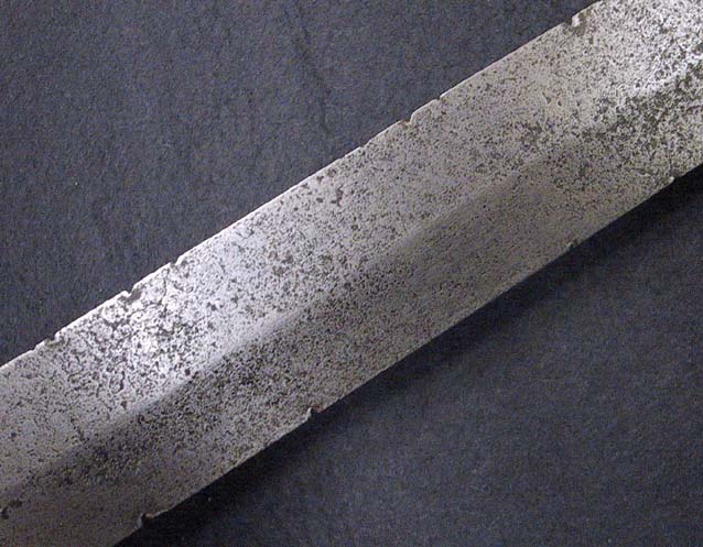

Just an example of what edge damage can look like.
The sword is from around 1500.
The blade is thin and flexible. Thickness behind edge is about wht you get on a typical vegetable knife. Last sharpening of edge angle is less acute than on such a knife though.
Still there is not much material.
Damage is small and shows cuts into the blade at a sloping angle of around 60 degrees lengthwise to the blade. On both sides of this cut the edge is flaked away diagonally towards each side.
This tells us that the sword met an incoming blade in a glancing, slanting parry. No static block. That would have produced a much deeper cut.
Hope you can see these details in the photo:
 Attachment: 92.19 KB

PostPosted: Wed 11 Jan, 2006 11:22 am    Post subject:         Reply with quote
Hi Peter,
Thank you for posting that photo. It almost makes me feel better about some of the damage that has been inflicted on my swords. Certainly my parries would not be the same quality as that of a swordsman whose life depending on his parries, Happy but the damage looks quite similar. Do you think those nicks were from one fight or several? You mentioned the "last sharpening", could there have been more damage that was removed during a previous sharpening?
Thanks.

PostPosted: Wed 11 Jan, 2006 11:46 am    Post subject:         Reply with quote
Note:
To get an idea of the amount of damge: the deepest nicks are not much more than 1,5 mm deep.
A sharp edge is *much* more fragile than a blunt edge on a training sword.
For contemporary swordsmen this can still be something to help create a perspective of the strength of the sharp edge: A swordfight *will* damage a sharp blade to some degree. As with any tool you will have to do some resharpening and maintenance.
Even in ancient times you could make edges "stronger", but that would be to the price of cutting performance. Looking at authentic blades in god condition it is obvious they sought to create as sharp an edge as possible with reasonable durability.
Final sharpening angle will also depend on the overall thinness of the blades and typical resistance: large thin bladed warswords who will have to survive contact with arour can have narrow, rather blunt secondary bevels. Thick diamond sectioned blades can have an invisible trasition from main bevel down to cutting sharpness.
Light baldes that are not going to see contact with defensive armour are acute indeed: very much like very sharp knives.
To build sturdier blades types like XVII and XV were developed that had more meat behind the edge, but the final edge angle (the one that produces the sharpness, not the main bevel) was more or less the same.
That is what I mean with "the last sharpening": the final angle of sharpening that produces the cutting edge. It is normally a smooth curving transition from main bevel to acute sharpness.
Anyway, this was a deviation from the theme of the thread.
A blunt sword for training must obviously be built to take severe punishment, but should still be used keeping in mind how a sharp sword can and cannot be used. That is the focus for the traning after all, is it not?

After reading Stephens post I feel I need to qualify my previous answers somewhat.
The topic of parry is a very worn one, but as with the nature of the sharp edge it seems it can never be exhausted...
I very much agree that we need to aproach the material with an open mind to get closer to a good interpretation.
Damage seen on surving blades is commonly of the type I showed above. You do find other types of damage as well.
There are those notches that are small triangular chips that has been struck out f the edge. To me that is the mark of a parry between blades that has met at a blunter angle and perhaps with more of a blocking effect. This kind of damage can be deeper than the slanting cuts, but is often surpricingly shallow.
It is easier to see this type of damage on later era swords (16th C and onwards: thin bladed C&T swords). That might mean something, but could just be a freak effect of the nature of surviving material.
You also see more dramatical damage like small hungry semicircular bites being taken away from the blade. These can be half a cm deep or more. To me that could be the effect of a sword hitting a ridge in armour or some other hard solid object (a poelarm perhaps?). This type of damage can be so severe as to make the sword blade in need of replacement. This damage is more rare to see. Perhaps that is because of blades thus damaged were quickly replaced? It could also mean that this type of damage was not very common. It is impossible to say.
I will maintain however, that a hard static block at right angles across the edge will risk rather deep nicks in the opposing swords. I do not mean to say such an action will make the blades break in that instant, or that this was not done. The result will naturally vary with different types of swords. If lighter blades meet the effect can be less severe.Those swords with sturdier geometry will also not suffer as much damage if they oppose a blade with thinner section. Naturally it is impossible to say just how damaging the effect is. There are so many variables. It might just be good to point out that an interpretation that makes use of mostly static blocks is not probably very realistic. I made this point as Bruno remarked that his teacher´s sword looked like a saw blade.
Based on what I´ve seen of damage in surviving swords it seems to me that the most common way to oppose an incoming attack with your own sword was a deflecting countercut at a slanting angle (in those instances when the blades actually did meet, that is). That type of damage in the edge is very common.
I have not made statisics of this, so what I say is not scientific. Only a testimony of my impression.
I gree that you will oppose an incoming sword in just about any way you can. I also think that training and techniques will favour and develop those methods that are most effective and least detrimental (applies to both swords and the swordsman) but that in the actual fight you might do something other than what you trained for (perhaps run away?Big Grin).
This thing with parries, damage of blades and resiliency and performance of the sharp edge is surrounded with much speculation and misunderstanding.
