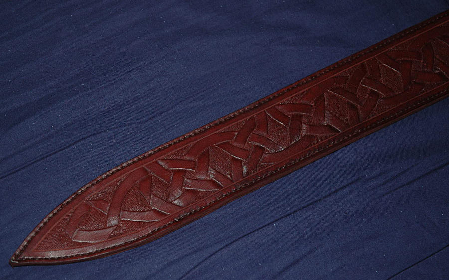

Hi, i made my first leather scabbard and wanted to share it with you. Happy
Its made of 3 layers of leather and i used wax thread for stitching.
I`m thinking about putting in some rivets but i`m not sure if it was done back then.

Info on the tools for making the Celtic design;
The background with these tools.
http://www.tandyleather.com/prodinfo.asp?numb...p;mitem=16
The outline of the Celtic pattern was done with this tool.
http://www.tandyleather.com/prodinfo.asp?numb...p;mitem=24
To get the sewing holes correctly.
http://www.tandyleather.com/prodinfo.asp?numb...p;mitem=51
Sewing tool.
And the Adjustable Stitching Groover to lay the thread deeper.

...Its made of 3 layers of leather and i used wax thread for stitching....
Eric,
what type of leather did you use? I vaguely recall one or more forumites remarking that some types of leather are bad for the steel.
And why did you use three layers of leather?

I didn`t know that, i used cow hide. 3 layers are used to protect the thread from the sharp edge. The middle layer is cutout to accommodate the shape of the sword.
