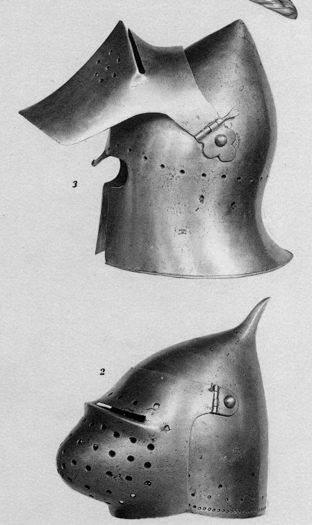

What it looks like to me, is someone going to a armourers workshop, takes a look at a pig face bacinet and a Sallet, scratches his head, and says: "Can I have that one with that visor, because that pointy bit looks a bit, well, silly?"
Hell, It's what I would have done... Razz
PostPosted: Tue 20 Dec, 2005 9:56 am    Post subject:         Reply with quote
It could be some form of great bascinet. I swear I've seen something similar, at least in period artwork. I'll look around and see if I can find anything.
I think this is the same one from the thread Greyson linked to:
If it's the top one, then it looks like a visored barbute or something. Strange.
[/list]
This helm is not e barbute for me-it has different shape of the top of the bell.Only the the face part is barbute-like.
Thanks for reply. Wink So you think that it is 14th century helmet?I was thinking about 1420-1430 period....

PostPosted: Tue 20 Dec, 2005 11:08 am    Post subject:         Reply with quote
The caption says 15th century. Why is that thought to be wrong?
PostPosted: Tue 20 Dec, 2005 11:15 am    Post subject:         Reply with quote
No, I didn't say it was 14th century. Happy If it is, it'd be very, very late. I'd say early 15th. It is more pointed than a typical barbute. My guess is that if falls somewhere in between in between a (great) bascinet and a barbute. It wouldn't be the first helm from the Middle Ages to defy classification. Happy

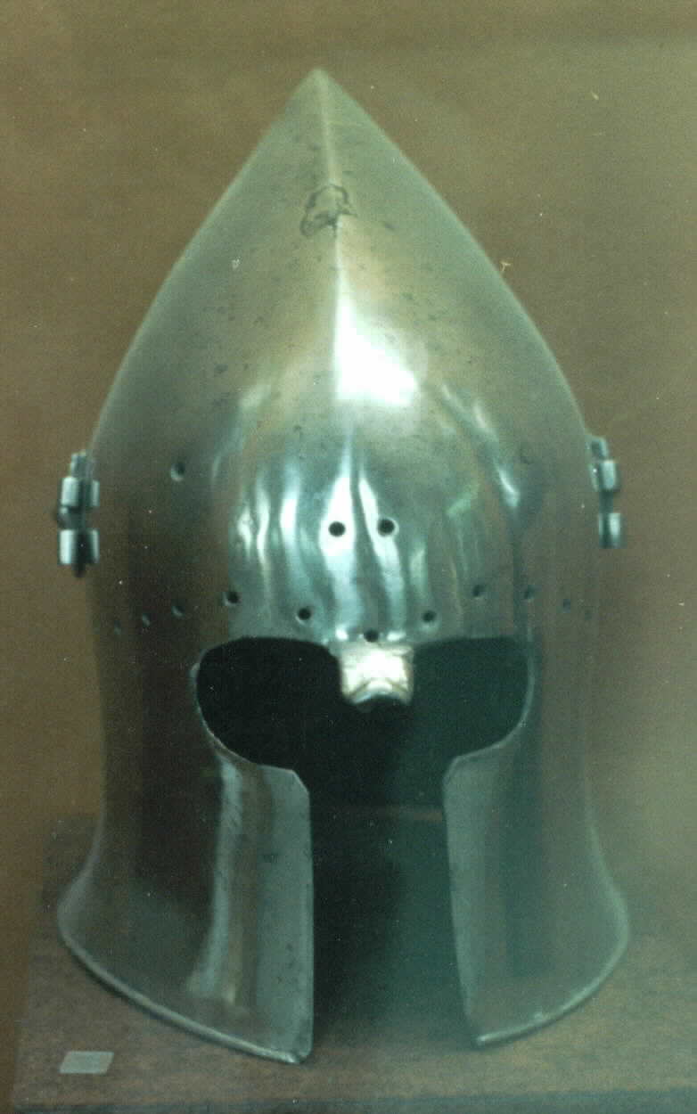

PostPosted: Tue 20 Dec, 2005 11:19 am    Post subject:         Reply with quote
Here is a helm that is not the same, but might share some of the same characteristics. It's of Venetian-style, early 15th century. It is said to derive from the barbuta but closed like the elmetto. It was discovered in the Greek castle of Chalcis and bears the marks P and N, made by two craftsmen, probably from Milan.
 Attachment: 52.24 KB
Venetian-style Helmet -- early 15th century
Museo Civico L. Marzoli, Brescia, Italy
PostPosted: Tue 20 Dec, 2005 11:20 am    Post subject:         Reply with quote
Yes 15th century.But which decade?1400-20 or 1420-50?
Without seeing more documentation, I'm not sure.
This helm has been discussed in this thread: http://www.wolfeargent.com/cgi-bin/ultimatebb...p;t=000183
A gentleman there said this:
Firstly, (ignoring the pointed bowl, which is in the same family as the St. Mary Chapel sallet in Coventry) the form of the skull bulge and tail, which do not occur in a 14th century context. Secondly, the shape neither allows for the ubiquitous camail and verveles of a 14th century bascinet, nor does it have mounting points for such. Thirdly, 14th century bascinets do not normally have rolled edges, and this clearly does. Fourthly, barbutes of 'corinthian' form all consistantly date between 1440 - 1460, Fithly, it is attributed to Missaglia - even if the mark is a historic forgery (as was occassionaly done to pieces to sell them for more value - sallets with 'a touch of Meylan' were regularly listed as being of more intrinsic worth in English inventories), it is a mark that did not exist until the 15th century. Sixthly, the visor is clearly of a 'frogface' form, which did not develop until the mid 15th century in a lifting visor.
It makes a very strong case all together for dating the piece in a mid 15th century context, assuming it is genuine. (the more I look at it closely, the more inclined I am to think it is, albeit unique).
PostPosted: Tue 20 Dec, 2005 12:31 pm    Post subject:         Reply with quote
Nathan,
This is a fascinating specimen. It looks like it has the vestiges (a domed rivet and a hole) of a center pivot/hinge of some kind. It also uses kind of proto-armet construction, with the hinges at the cheeks and what appears to be a stud closure at the chin.
Weird, but cool.

PostPosted: Tue 20 Dec, 2005 6:18 pm    Post subject:         Reply with quote
The visor sort of reminds me of the front lower part of a Frog Mouth Great Helm: Don't know if this helps much.
Looks like a Bascinet with a lot of Barbute mixed in.
