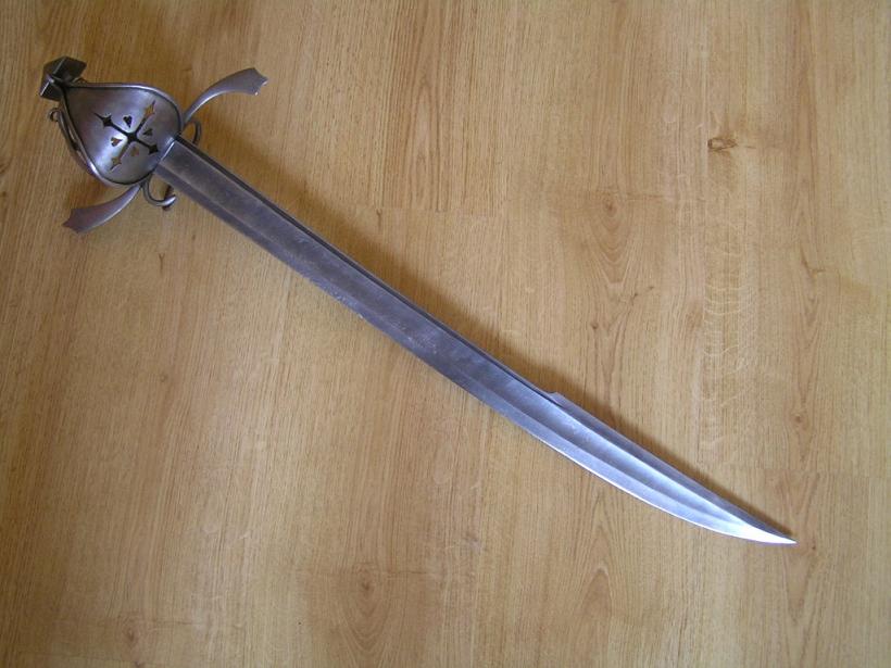

I think a light falchion would make a terrific slicer!
Here is a picture or two of one made by Vladimir Cervenka;
Richard.

Sa'ar Nudel
Posted: Thu 14 Aug, 2008 9:32 am Post subject: |
Richard, that's a wounderful sword. I wander how it handles - weight, balance, "feel" etc. I had a chance to handle one of Del Tin's first Dusscks which is basicaly very similar, it felt too heavy to size and the hilt was narrow for my average+ hand. Fit and finish were superb, though.
I would think also that messer & dussack techniques can both work well with a falchion, as those three weapons are similar in size and sometimes in shape; more to it - the boundries between them are blurry and sometime they overlapp each other, depending period and location.

Posted: Fri 15 Aug, 2008 1:12 am Post subject: |
That certainly seems like a thin blade, I bet it is very light and fast. I would worry about it's sturdiness though. It seems like any resistance would fold a blade like that over...
-Rusty
Werner Stiegler
Posted: Fri 15 Aug, 2008 5:02 am Post subject: |
| Rusty Knorr wrote: | | That certainly seems like a thin blade, I bet it is very light and fast. I would worry about it's sturdiness though. It seems like any resistance would fold a blade like that over... | Thrust me, a blade that can be bent like that and return true won't be bend out of shape by anything less than smashing it against a rock over and over again.

Sa'ar Nudel
Posted: Sat 16 Aug, 2008 12:18 am Post subject: |
Thanks Richard, this will be great. I've noticed the work of Vladimir myself, they look awsome but of course weight and 'feel' cannot be transfered (yet) via monitors...

Richard Hare
Location: Alberta, canada Joined: 15 Mar 2008
Posts: 135
Posted: Sun 24 Aug, 2008 6:08 am Post subject: |
Sa'ar,
Vladimir got back to me re. the falchion.
He says that he has heard a review might be coming up of this sword here at myArmoury!
Regarding measurements, Vladimir has not got anything specific. He made this sword three years ago and has no recorded details.
He did offer approximate statistics as follows;
Blde length..................700mm
O/all length..................895mm
blade width, @ hilt.....43mm
blade width near tip...50mm
weight...........................1080 grams.
Hope this is of some help!
