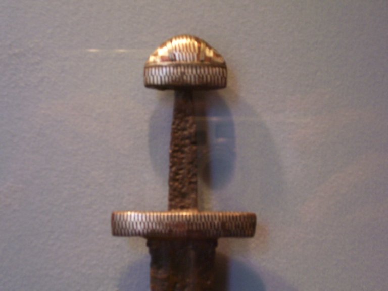

I have a couple of relatively good quality photos of inlaid hilts to show.

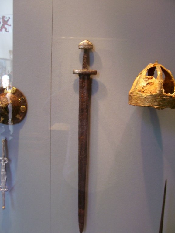

the pics are blurry but this is a sword from the MET.

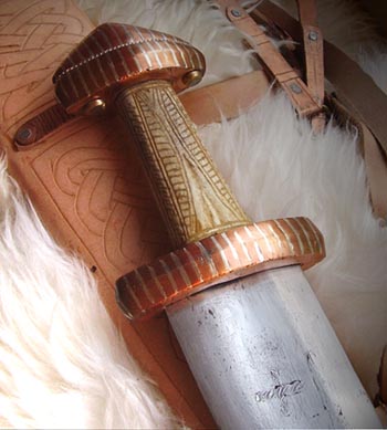

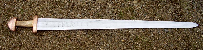

Below is pictured my version of the type H sword from the Netherlands. I have been experimenting on pattern-welded inlays for my doctoral thesis in archaeology, and this blade is one of those experiments. The blade is 18th-century steel and the inlays are pattern-welded. Having enough bare blades at the corner of my livingroom, I have been trying to make hilts according to some finds. The hilt for this sword, as well as the measurements of the blade, were taken from the find from Netherlands.
The hilt is iron, covered with copper and silver wire inlays. The inlays were attached by undercutting channels for them. The inlaid wire was 0.8 millimetres in diameter, so the number of inlaid wires is much smaller than in the original. In my version there are inlaid alternately one silver wire and two copper wires, while in the original every strand is comprised of several thinner wires.
I am currently experimenting a technique with which to inlay smaller wires more densely. Some finds show that there could have been three wires inlaid in a distance of only one millimetre. I find it very difficult to achieve by undercutting channels. I made one test piece from 18th-century iron, in which I struck very narrow channels with a knife blade. A chisel would do the job too. Since this iron is considerably softer than modern alloys, it enables to inlay a wire in this kind of groove. The trick is to inlay a wire, which is a bit wider than the upper part of the struck channel. When the inlay is hammered into its position, the edges of the hacked groove will bend inwards locking the inlay into position. I inlaid 0.3 millimetres thick silver and copper wires in this manner, and the outlook is very similar to finds. Still I need to make a complete hilt to make sure the technique really works...
The guards were forged, as well as the hollow pommel. I used a kind of resin to attach the U-shaped rivet inside the pommel. The resin was quite the same as previously talked about in this thread: mainly pitch, some beeswax and wood filings as binder. The mixture held surprisingly well, although it is very sensitive to changes in temperature.
The decorative wire between the pommel and the upper guard is beaded silver wire.
Comments and thoughts are very welcome!

PostPosted: Sun 24 Aug, 2008 3:24 pm    Post subject:         Reply with quote
Mikko That is some stunning work!!.. Happy I love it.
did you do all the inlay with traditional tools and no power tools??
And the grip looks beautiful! what is it crafted from??

PostPosted: Sun 24 Aug, 2008 10:01 pm    Post subject:         Reply with quote
Andrew, thanks for the comments.
All work was done with traditional tools. The chisels with which to cut the grooves for the hilt inlays were self-made. Actually, only hammers and anvils are industrial, all other tools are made from scrap iron and steel. Everything was done without electric tools, excluding the air blow in the forge. The polishing work was also done with different grinding stones, fine sand and various pastes available also to the Iron Age craftsman (or so I believe).
The grip is carved antler, a very thick one. Actually the model can be found in Historical Museum in Stockholm. There is a sword (with its blade missing, Petersen type V if I remember correctly), which has a same kind of grip made from bone or some horn. Even the majority of the decorative carvings are preserved.
You do also excellent work! I noted your homepage already a long time ago. The blades look elegant, and especially I like the carving work!
