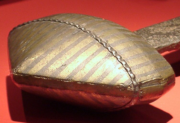

I've taken a few more close ups of the sword in Leiden, so here they are:
 Attachment: 113.72 KB

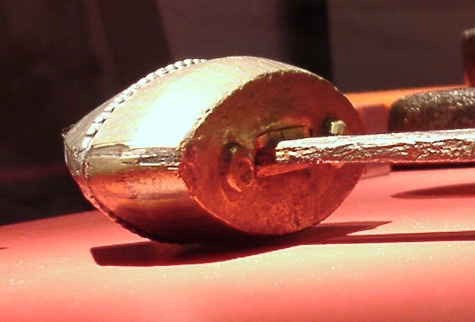

Number 2:
 Attachment: 103.18 KB

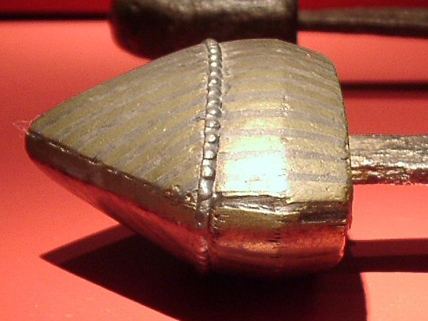

Number 3:
 Attachment: 86.58 KB

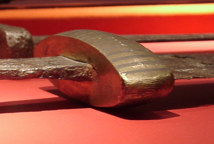

Number 4:
 Attachment: 105.23 KB

PostPosted: Sun 04 Dec, 2005 9:41 am    Post subject:         Reply with quote
Thanks a million for the photos!
The transitions between surfaces are the hardest things to figure out on these hilts, it's great to see the inlay switching direction along the top of the pommel.
Jeff
It may be just the lighting, but, in these photos, the hilt appears to have some sort of coating on it, almost like a thin paint.
??? Does anyone else see this?
