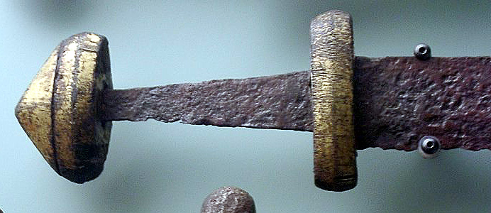

Here are a few more pictures of Type H Viking swords with wire plated hilts.
This picture from Ian Peirce's "Swords of the Viking Age" of a sword from Kilmainham Ireland shows the wire inlay coming loose.
ks
 Attachment: 99.98 KB
Total Length 97cm, blade length 79cm, grip length 91mm

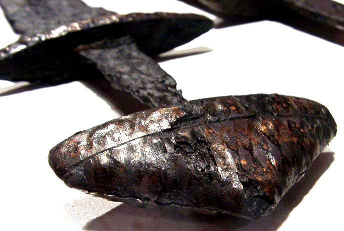

 Attachment: 92.84 KB
Photo by Jeroen Zuiderwijk

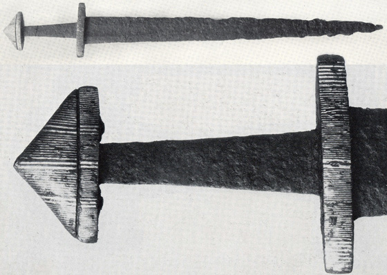

 Attachment: 84.53 KB
Barkarby Sword from Pierce's "Swords of the Viking Age" alternate silver and copper inlay

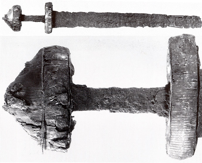

Here are a few more fancy plating jobs...
The first and last image shows inlay that appears to use twisted wires of silver and copper, inlayed at intervals to produce a diamond pattern.
ks
 Attachment: 99.33 KB
From Ian Peirce's "Sword of the Viking Age" Strandefjorden Hilt.

Sorry guys, Iíve been out of town for several days. It did give me a chance to think about and study some of these a bit more. So some of the points may be a bit on the random side of things, but just things I noticed.
The Kilmainham sword pictured above is a good example of how sheets have been inlayed to clad the hilt in certain materials. You can see where the sheets have started coming loose on the top and bottom of the lower guard and also on the bottom of the upper guard. Also noticed from Jeroenís last picture of the original sword in question that you could see where it has been clad in such a way as well if you look at the top of the pommel cap you can see the seems where the side plates join a strip that runs along the top of the pommel. Also if you look closely along this top strip you can see where the silver colored inlays were cut into the bronze inlay, this gives a look into the different steps used when doing it. So I donít think the one area of striations we see on the pommel cap is where individual wires have been inlayed, but rather a low spot in the bronze inlay that shows the cuts made into the base metal that hold the inlay in place.
