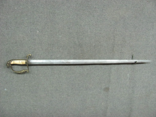

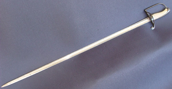

Broadsword is really a modern term that is used to describe a number of genre and types pf swords. I wouldn't get hung up on the term but rather look at the Oakeshott series of feature articles here at myArmoury.
http://www.myArmoury.com/features.html
It is generally easier to look at the Oakeshott classifications to determine a sword from the medieval period from the NOrman conquest up to the renaissance period. Then you have both earlier periods and later periods with their own jargon and classifications.
The basket hilts get labeled as broadswords or backswords to define whether there is a single edge or two. This holds sway even into the 19th century to differentiate between a spadroon or broadsword.blade. Both of these latter are actually quite slim blades in comparison to a broad medieval type.
My 1850s eagle pommel is an example of a late British broadsword blade. Then compare that to a backsword or spadroon. To confuse things further, many swords will be labeled as cut&thrust Wink That, perhaps to lead that such are narrower pointy things but still have a working edge.
