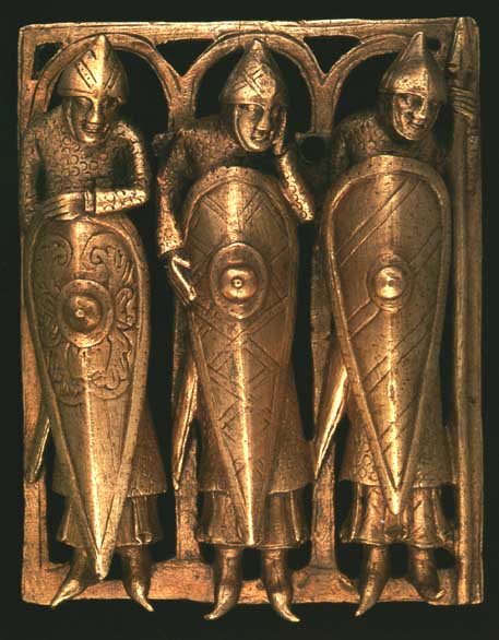

For what it's worth, I was thinking of the middle shield in the picture below as inspiration.

That pattern is something I've been tempted to try myself. I like it a lot. Off hand I don't know of any good source of exact colors for the period. I have seen an illustration in Osprey's The Normans that shows that pattern in blue and yellow. It looks to work pretty well like that. When choosing colors for this stuff I personally don't get too hung up on exact shades, etc., as I feel there was quite a bit more variety than is commonly held by today's 'plain Jane is better' crowd. It just depended on what you could afford. I've been told that by those very knowledgeable in migration era through early medieval designs. When choosing colors I try to envision something that wouldn't have required a lot of exotic pigments or minerals to achieve but is a step or two above raw burlap and leather.
I'm sure someone will chime in with some better sources of info on available pigments.

One possible inspiration for color combinations might be the much-derided color scheme of the Bayeux Tapestry. It clearly isn't naturalistic, and I am sure the colors are not exactly as they were when it was new. However, the mix of colors might give a fair idea of the palette available, and how they were combined.
