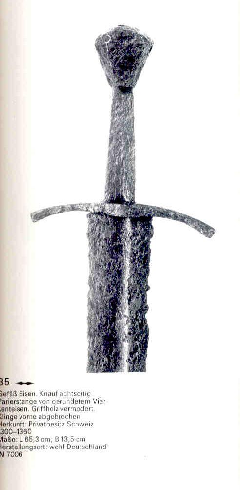

Got hold of this picture, anyone know more about this sword? Any fullsize pictures out there?
Attachment: 45.19 KB
W. Stilleborn wrote: |
Got hold of this picture, anyone know more about this sword? Any fullsize pictures out there? |
Do you know what museum collection it's from or where the pic came from?
Currently looking into that.
For some reason, I think that last sword pictured is in a museum in Copenhagen (same one as the XVI.3). I can't prove it, though. It just seems like I've read a caption to that effect somewhere.
I don't know if it helps, but according to the description the sword is dated to 1300-1360, its find place is unknown, but most likely somewhere in Germany and it is currently in a private Swiss collection.

Not planning on doing any costumizing, but thanks for the tip. Im trying to find an original for a custom order. Im almost leaning towards the XVI.3 at the moment, after seeing that superb repro by Jason Dingledine. But hoping to see the full pic of that other XVI before i decide. As far as i might enjoy the XV swords and thinking they are the best-looking individually, i have sort of realized most of them would not fit too good together with a german 14th cen outfit consisting of much splinted-leather-limbs and Visby-type gautlets.
But hoping to see the full pic of that other XVI before i decide. |
As an additional note, the caption also indicates that the forward section of the decayed blade is broken off, so I'm not certain how complete a sword this may be.
Darn, that was the only thing my spotfilled german didnt cover...
