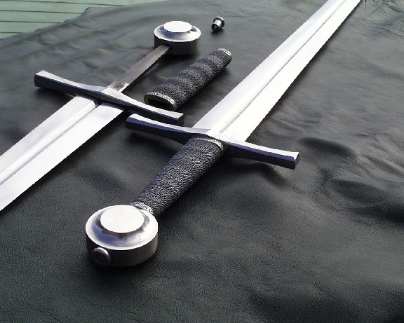

PostPosted: Sun 18 Sep, 2005 1:42 pm    Post subject:         Reply with quote
a pic of the construction that i use.
 Attachment: 85.82 KB
PostPosted: Sun 18 Sep, 2005 1:52 pm    Post subject:         Reply with quote
Hey Rob, those are some fine lookin' swords there.

That sword you've posted has always been one of my favorites from your line-up. Very nice looking, and even though the construction method isn't my first choice it wouldn't stop me from buying one.

That was the pic I originally tried to include in my post! Thanks Rob, it's nice to hear what you have to say considering your actually making the swords.

Wow, Rob, that's a beautiful sword. I cant be certain what the grip covering is, is that wire? the pic is juuust grainy enough that I'm not sure. Just beautiful, man, kudos to you. Big Grin
Yes, it's wire with silver ferrules. Rob offers a lot of options on that particular sword.

Rob Miller wrote:
the construction i use does not have an Historical precedent,as stated,it is to facilitate a breakdown of the components,whether that is to your taste or not,a lot of people like to take a sword apart and examine the tang stamp and construction,this is my choice,it also allows for a change of guard,grip and pommel.
That's just what I like about this sort of construction. I certainly appreciate the historically accurate methods used by Albion, for example, but as somebody who loves to tinker with all things mechanical, a hilt that can be disassembled is a strong selling point.
As for the durability of such construction, their may indeed be greater stresses on the hilt, as Patrick suggested, than on a hot peened hilt, but is the difference really great enough to make a lot of practical difference? As Chad stated, Gus Trim's swords are, with the exception of a few custom examples, assembled in a very similar fashion, and I think it's safe to say that they have proven extremely durable. Question Happy
