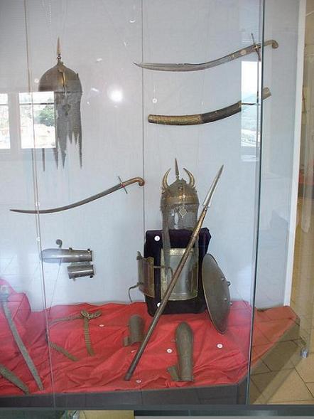

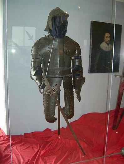

Hello everyone!
I am sending you two pictures, which I took in The Slovakian Historical Museum about a month ago. The both armours are dated about the time of the battle of Mohacs, so we can say that they are at the same age. Note that the Turkish armour IS NOT an heavy cavalryman's armour. It misses also the maile. (Sorry for the blicks over the glass Happy )
So, I think that at that time the European armour is better than the Islamic in its protection capabilities. The Turkish victories were deu more to the higher discipline of the troops (note, for exaple the battle of Varna, 1444) and/or numerical advantage, rather than any significant superiority in the arms and armour. These deductions, of course, have elements of simplicity, but in general are correct.

Boris Petrov Bedrosov wrote:
Hello everyone!
Best regards!
Boris
Greetings Boris! Glad to have you aboard. I would suggest , though, that the Western-style armour shown in your post is not from Mohacs, as it looks to me to be from about a hundred years later. The curators must have mislabled it at the Slovakian museum. It's definitely of the style popular during the 30-Years War, though it could possibly be from the very late 16th Century.
Thanks for the post, and for resurecting a very interesting thread.

PostPosted: Thu 24 Nov, 2005 9:45 am    Post subject:         Reply with quote
Hi, Gordon!
You may be right, I don't know. Surprised Actually, I'm not so big fan (did you see what ugly word I used Laughing Out Loud ) of the European armour. So, my knowledge about them is not so wide as I want it to be. My great passion are the Japanese arms and armour and European swords (in wider meaning of the word) .
I'm glad that you like the pictures.
