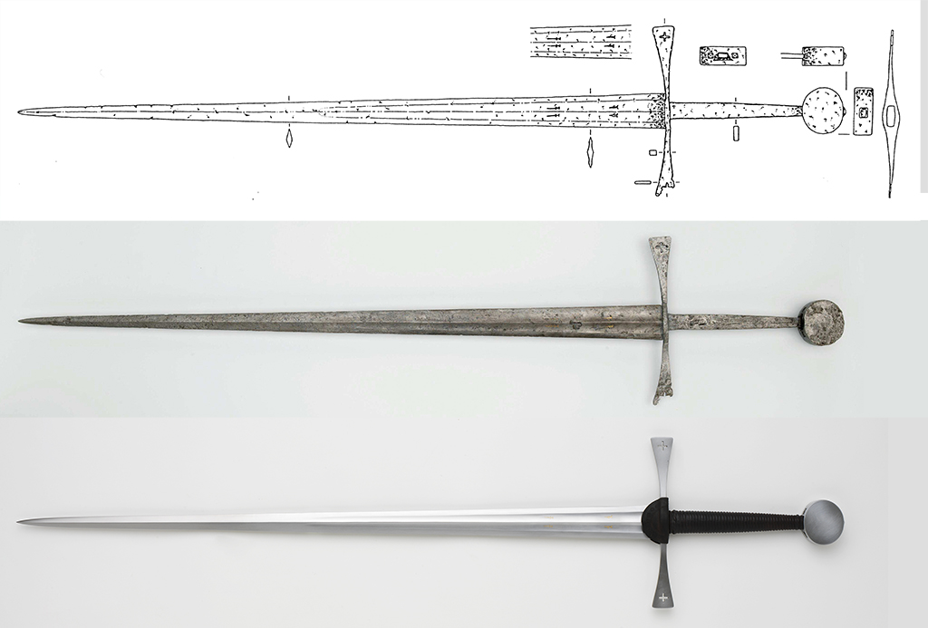

Since the criteria for assigning a sword to a specific Oakeshott type isn't really that exact, this isn't so simple. For instance Peter Johnsson and Albion classify National Museum of Slovenia sword N4516, and it's replica Albion Ljubljana as Oakeshott Type XVIIIb. I guess the main criteria for assigning it to this type is a slight widening of the blade near the tip, and the curve towards the tip. I think this is a bit more prominent on the replica, Albion Ljubljana as it is on the original, but this might be Peter Johnsson's reconstruction of original shape of the blade due to the angles in cross section and evidence of reshaping in it's working life, probably due to damage.
But National Museum of Slovenia sword N4516 and it's replica Albion Ljubljana are much more typical thrust oriented sword than typical Type XVIIIb - it has a very strong profile taper, while the blade thickness remains very high, so the cross section at the Centre of Percussion, although it is quite back, isn't very cut optimized.
 Attachment: 9.11 KB
 Attachment: 161.03 KB
 Attachment: 558.98 KB
 Attachment: 192.33 KB
I dont remember seeing a type XVIIIb with a fuller, this reminds me more of a Brescia Spadona. I'm not an expert on classifying these typologies (and Peter once said he changed opinions on some stuff he classified in the past, great guy btw), but I would suggest either a type XVIa or a hybrid.
By the way, the original you send has a fillet/ridge/spine in the center much like the ones seen in estocs/panzerstechers. I think this was lost in the Albion interpretation somewhat.
Some of these were made in longsword and one handed sword blades, probably to remove weight and not going full diamond shaped.
https://www.metmuseum.org/art/collection/search/25627

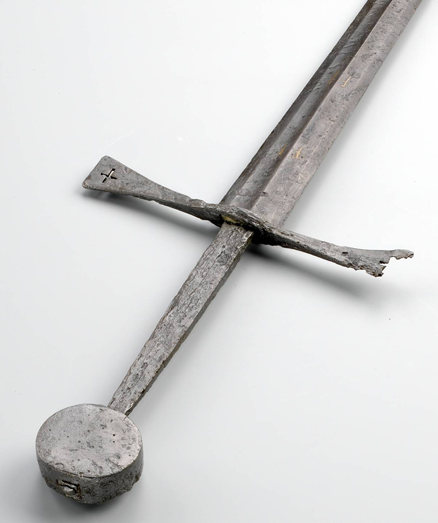

Well, the National Museum of Slovenia sword N4516 doesn't fit any of the Oakeshott typologies neatly, and that's why it could be placed in many of them - with notes on how it differs from the type standard.
It might look on some photos like Albion Ljubljana is different than Slovenia sword N4516, but it's mainly just due to different lighting, corrosion and patina on the original that sometimes masks the shape or makes it look different than it is. The " fillet/ridge/spine in the center much like the ones seen in estocs/panzerstechers" is the ridge on the wider part of the blade between the two shallow fullers. The general cross section shape is that of a diamond throughout.
 Attachment: 263.81 KB
