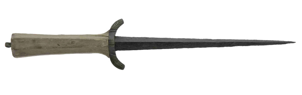

I found this image of a 14th century quillon dagger that (I think) was found in Leiden in the Netherlands along with its sheath in pretty awesome condition. The dagger used to be in the 'Museum De Lakenhal' in Leiden and may still be there. I did not find it when searching in their online object collection. Has anybody seen more pictures of dagger somewhere else or is perhaps sitting on some detail images? I ask because I want to make a copy of it and I'm wondering:
(A) Is it possibly missing a pommel?
(B) If it hasn't lost a pommel, how was the tang peened and finished?
(C) How thick is the blade?
(D) what is the design of the belt attachments on the back of the sheath?
Attachment: 128.46 KB

Yes it is missing a pommel, and the quillons look so mid 15thC, so I have a slight doubt over the 14thC attribution.
From the shadows, the blade looks to be quite thick at 7-8mm I would guess, though for this size knife 6mm would be more normal.
The fittings will most likely be folded over and soldered and the mouth will likely either have a ring or a staple for suspension - could be either.
There are a few very similar sheath fitting sets made by Arms and Armour, Josh Davies and myself and you will find these if you search here.

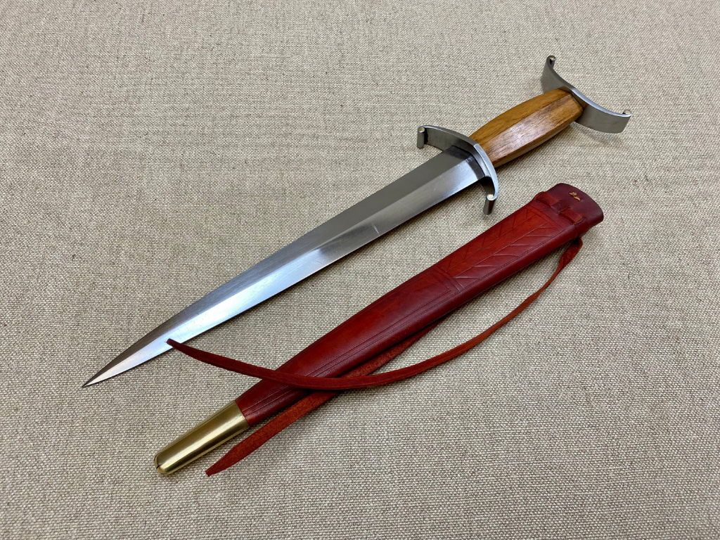

What made me suspicious was that little nib on the top of the handle. It looks like either a ring for a weapons chain or retention for a missing pommel. What kind of pommel would this thing ha have had? I was figuring perhaps an antenna pommel but it seems like the handle would be so heavy the dagger would have trouble hanging point down with a substantial pommel?!?
I was actually thinking it might have originally looked something like one of your creations (but with a shorter blade):
Also found another dagger just like this one in the Rijksmuseum van Oudheden collection:
Attachment: 924.64 KB
Attachment: 61.29 KB

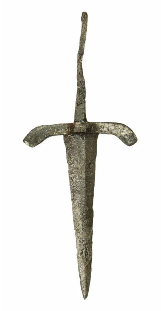

Here's another one. Found during excavations in 2002 of the Manour of the Lords of Arkel and the Grote School on the Krijtstraat in Gorinchem. Both the dagger form Leiden and this one seem to have been found in a 14th century archeological context. Interestingly this one has a tinned crossguard. It was found point down as if it had been driven into the ground and left there. There was no sign of a pommel.
Attachment: 45.26 KB
