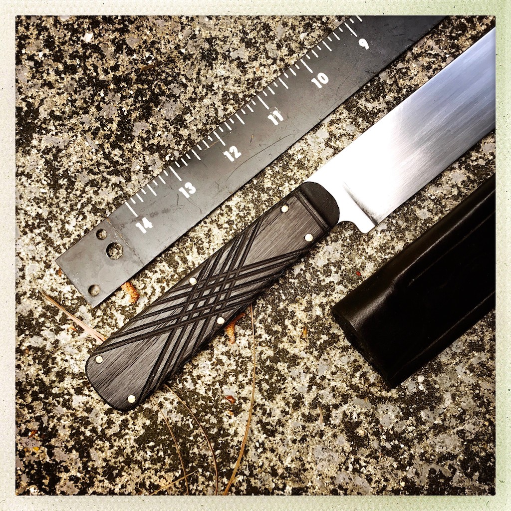

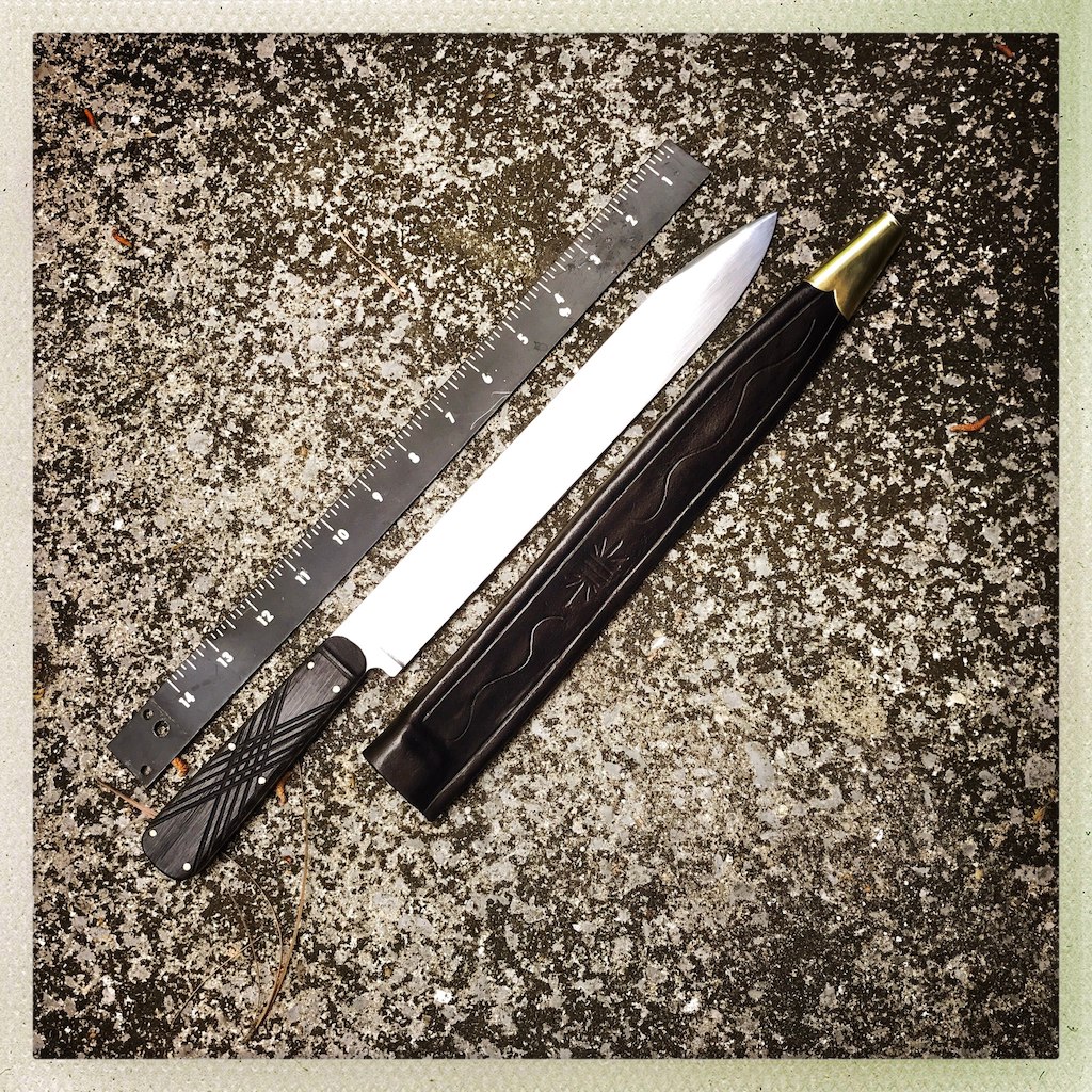

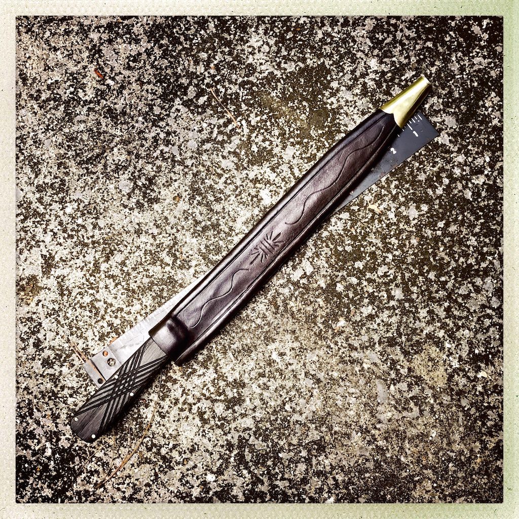

I set out to use a bare Crazy Crow rifleman's knife blade for a Bauernwehr project. I got most of the way there, but I've immersed myself so deeply in study of American knives in recent years that lots of little problems with the project kept nudging me in that direction. So, I gave in and made another guardless early American knife.
This one has the look of Antebellum America, but the decoration of the sheath is inspired by a scabbard from Mary Rose. I like it, but I still want a Bauernwehr.

Very nice! I love the scabbard tooling and cross hatching on the grip. What wood is the grip?

Thanks! These scales are dyed oak. I can’t find real ash wheelbarrow replacement handles anymore. Those were my source for polearm hafts and knife scales of this size. It’s easy to find oak slats for scales. Hickory would be great for these knives. I have a bag of small cherry sticks that are sold for grilling, but make wonderful small scales.

Looks great! What did you use for the scales?
It occurred to me recently that the "frontier rifleman's knife" is really an extra-long Sheffield Bowie, and not from the 18th century like they say.

Thanks! The scales are from oak craft slats I found at Lowes. I don't think I've ever seen them there before.

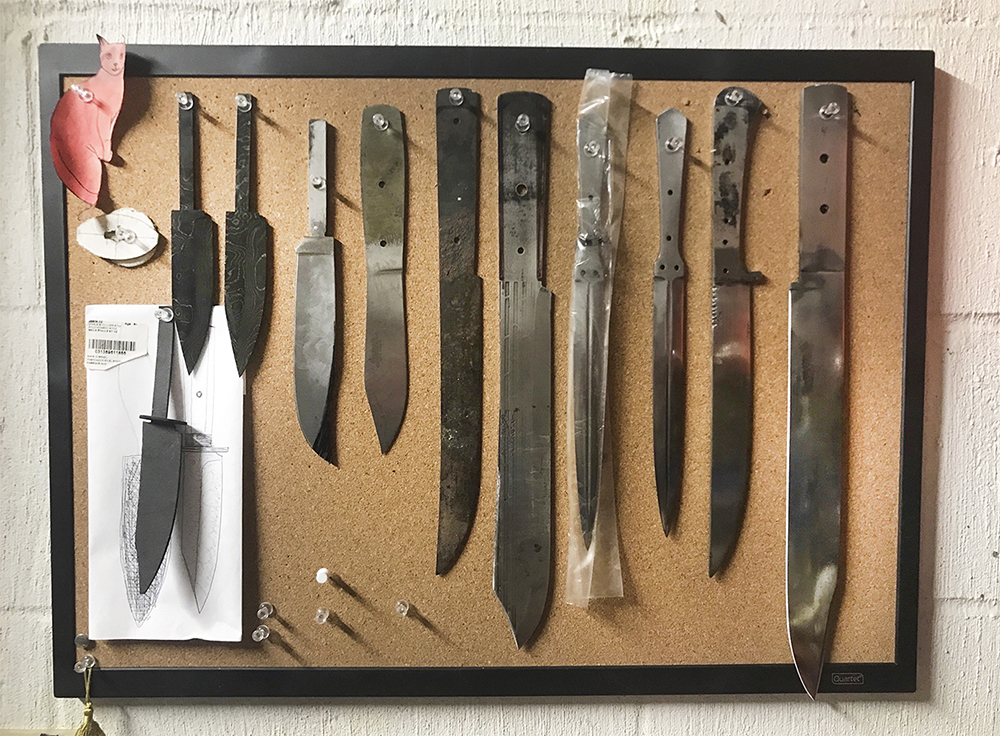

Very nice! I really like that. Do you have any photos of what the blade looked like when you started?

Sorry--I had some technical difficulties and couldn't respond. The stock blade of this type is hanging at far right in this photo. For my project, I've made the transition to the false edge a bit more subtle, and significantly altered the shape of the grip, which is perfectly rectangular in stock form. It's good that this gives the cutler some options, but this tang is so hard that it must be annealed to do any shaping.
The other blades are (L-R):
2 Alabama Damascus Steel blades (above a craft foam form used to model designs)
Generic bowie blade that needs reshaping and a mounting design
Green River
Old kitchen knife awaiting a project idea
Old Hickory butcher knife I started to reshape and then stepped away from
2 Atlanta Cutlery daggers
Atlanta Cutlery rifleman's knife awaiting a good idea
These are just my bare pierced blades. I have a drawer full of old kitchen knifes and un-pierced blades. Not enough time!
