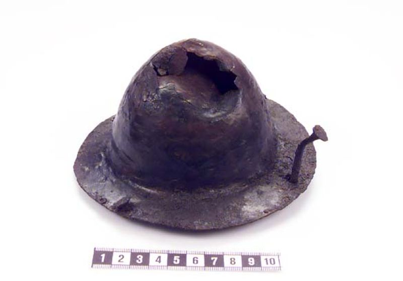

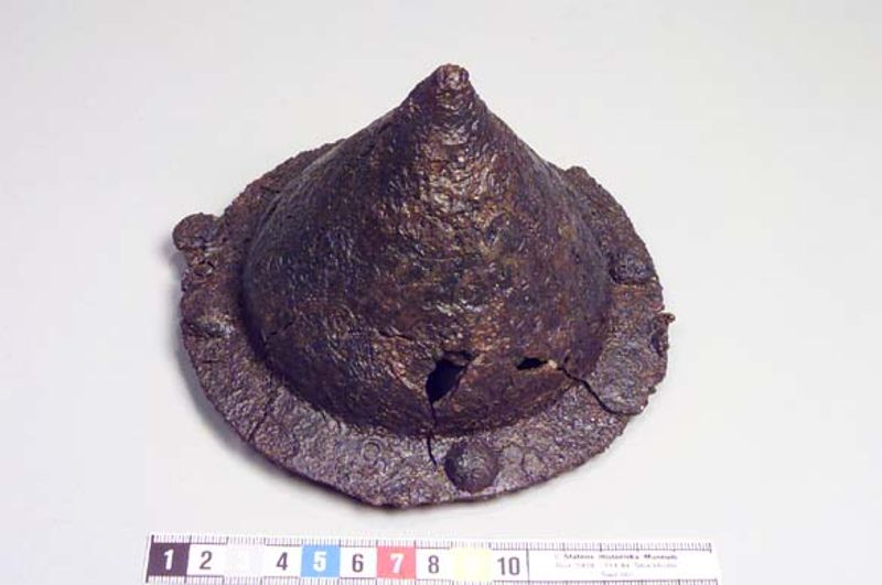

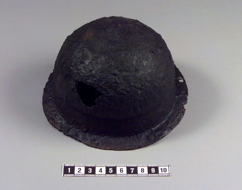

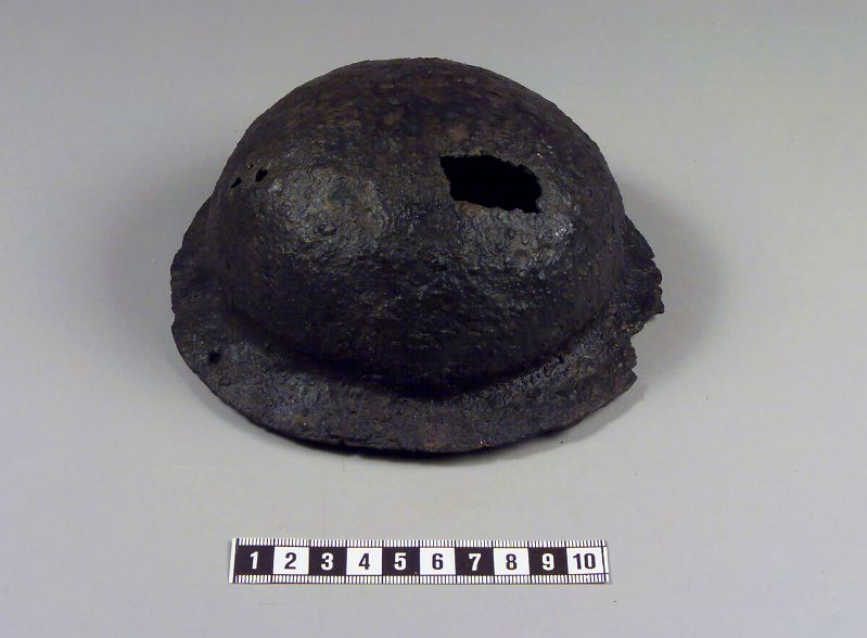

Viktor Abrahamson
Location: Sweden
Joined: 07 Aug 2008
Posts: 74
PostPosted: Thu 04 Apr, 2013 10:23 am    Post subject:         Reply with quote
Here are some pictures of shieldbosses including some measurement.
These are viking age shieldbosses found in Sweden.
Might be of some help.
This one from Vendel. (Not Vendel-time but the location)
Vendel
Grödinge, Södermanland
Sollerön, Dalarna
/Viktor
