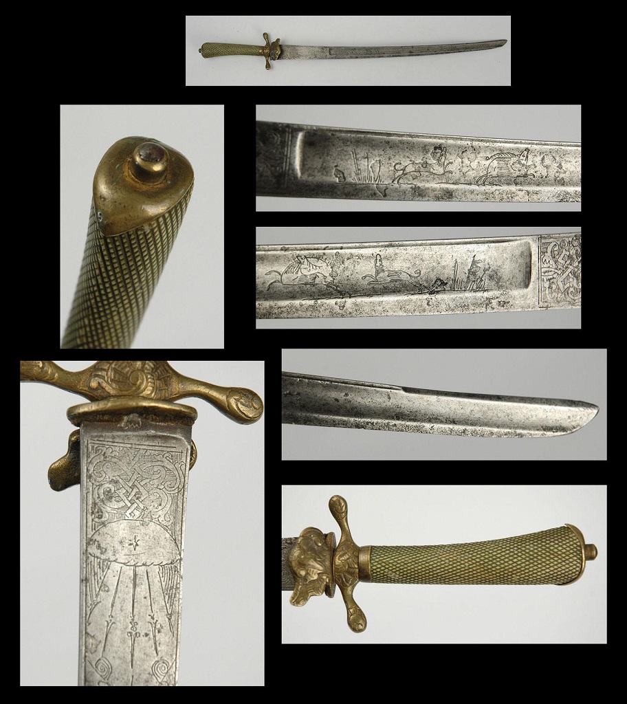

Hello. I've seen a number of swords, mostly small cuttoes and the like from the 18th century, which appear to have fullers that run right to the tip without the edges coming together at all, as if the blade had been made longer and then cut down. By their shape and other details, they don't look to me like actual longer hangers or sabers of the period that have been cut down, so I would guess that their fullers were shaped like this from the start, but why? Is the tip kind of thin if it comes to a spear point in the middle of the fuller, and if so, is that going to make it damage-prone if it strikes bone or other hard material in a thrust?
I understand that these are not heavy fighting swords, but it's still a strange and interesting detail.
 Attachment: 46.95 KB

Those cuttoe and a lot of spadroons have fullers right to the point. The image you showed is a blade that had been overly trimmed a bit (some inches).
A long one. You'll see the fuller right to the tip.
This is typical for these long ricasso fullered cuttoe blades.
A large number of spadroons share the same trait and even some broader sabres share the same "to the point" grind.
As these sometimes did get ground down, the look of through the point may be apparent and a good many shortened blade do show it. The way I look to determine on some is to look at the fuller itself where they start to curve. Sometimes one really has to have the piece in hand to determine if a blade was seriously cropped.

Thanks. So these cuttoes with open-ended fullers did originate as longer blades, but these were already cuttoe blades and not necessarily a whole lot longer, just that because the fuller already ran to the tip, shortening the blade by any amount resulted in losing the closed end. That makes sense to me.

If the fuller runs through the point, it is an indication of the blade being shortened, The one example you show was shortened by some inches, as much as four inches but at least a couple.
Can you post more examples of fullers through the point for what you see as normal?

Again, a trimmed blade. Blades break, or are otherwise altered. Both examples do not represent how they were originally produced. Whether a medieval sword, or modern bayonet, there may have been a want to shorten a blade but length offers the only perceived benefit. Some might argue it was done for a caping advantage but it dos not follow to me that it was a purposeful advantage.

I think I mentioned swords break. The 18th century saw a lot of broken swords. Usually towards the foible (pointy end). Thick at the hilt, reducing greatly by the pob and many wafer thin at the point. Flexible flyers until they stay bent or break. Premium cast steel billets (refined shear steel) were a late 18th century start to unified blades until Bessemer comes along.
On the other hand, I have German bladed spadroons that had fullers less than full length and one of those probably did break or bend just past the fuller and ground to a point.
I have to remain unconvinced the two examples Dan has posted were anything but repair.
