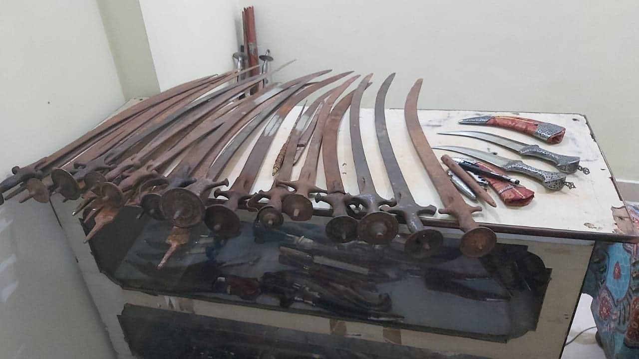

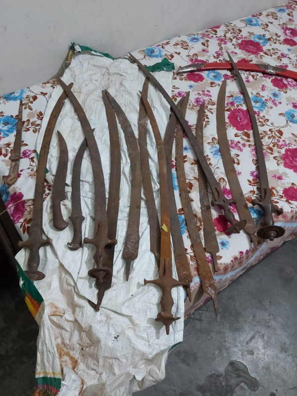

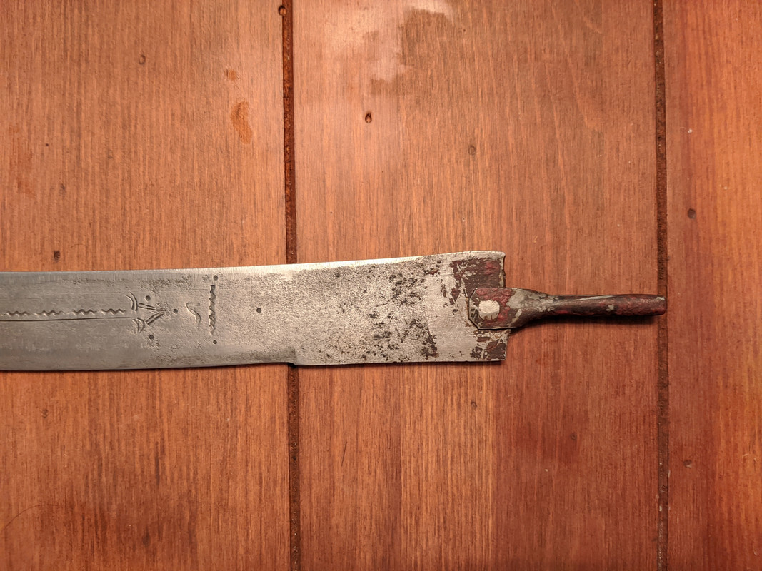

I recently bought a bundle of completely encrusted, munition quality talwars from India. I disassembled them for cleaning and inspection and found that one had a tang which is riveted to the blade. It is a piece of metal folded into a 'V' sandwiching the base of the blade, and riveted through. It is free to pivot to some degree in both directions.
Have you encountered anything like this before?
My first assumption was that it must be a repair (hard to say definitively) and certainly inferior to a monolithic tang but, probably only coincidentally, it proved to be the most difficult blade to extract from the hilt.

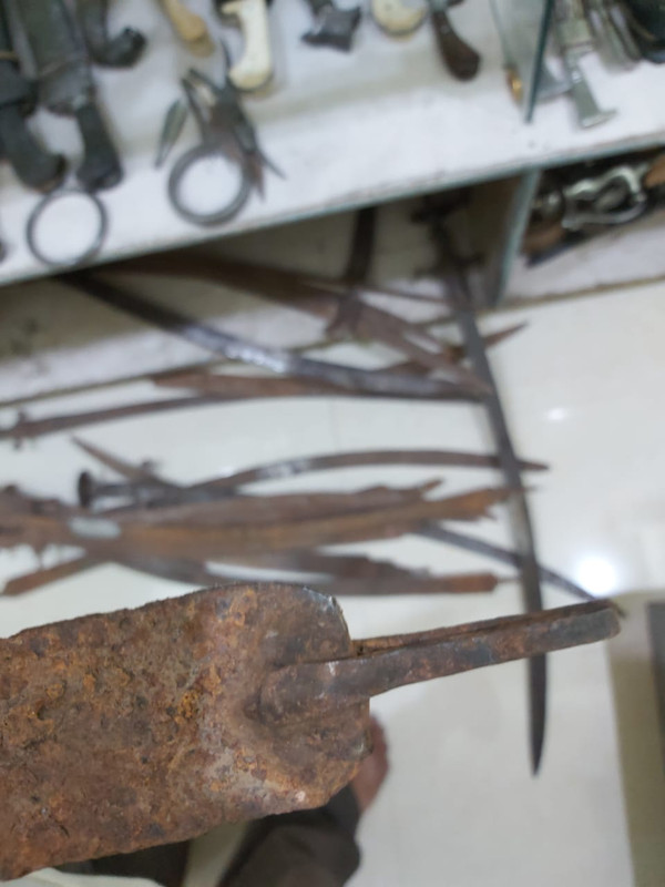

Interesting, here are some pics for reference:

Sean, what leads you to think it is post 1945? I am interested to know how to spot it, because the overall condition the lot arrived in had me thinking earlier. I would have guessed mid to late 19th century. It was so encrusted, one could barely make out any of the decorative marks. It does certainly seem mono construction, though one of the other swords in the lot turned out to be at least folded/pattern welded.
The smith I bought them from also manufactures new swords which you would pay 2-3 times as much for, so artificial aging wouldn't make sense. This was the condition before cleaning, maybe in a very humid climate this is what 60 years of 'patina' looks like.

A chapter of my PhD thesis was on Iron Age arms and armour, and I have never seen a sword with a tang like that which was made before the 20th century. Riveting on a tang makes sense if you have sheets of rolled cast steel which do not forge weld well. It does not make sense if you have bloomery steel which forge-welds easily so you can forge-weld a nice soft iron tang onto the blade. My feeling (and its just a feeling, ask Indian or Pakistani friends) is that factory steel probably drove indigenous steel out of use in rural India in the early 20th century. So its unlikely to be older than the 20th century.

So, I asked the smith, he immediately told me it's a repair. The blade he thinks is late 19th century, the repair could have been done any time, but he hazards 20th century. He said it's not unusual to see either welded or riveted repairs based on the ability or resources of the person doing the repair. Here is a photo of a similarly repaired blade in his inventory:
