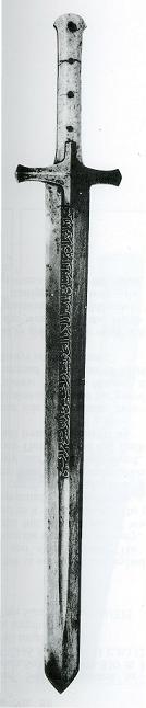

Hand and a half short sword....nope, that's not weird at all. I love those things.

The shortened blade thing reminds me a bit of something I thought of related to a recent thread where the new MRL Saladin sword is mentioned. I dislike the forked tip... I suppose it wouldn't be impossible to modify it by cutting it back and reforming the tip.... Ofcourse, I'd need money to buy the sword, so that is out.... lol

Very cool! A serious chopper :eek: ! I love the way the tip on that one is more the suggestion of a point, rather than something more acute. Nice. :cool:
