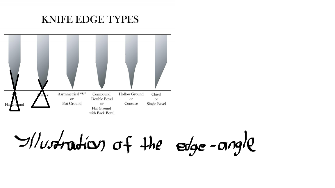

| Blaz Berlec wrote: |
| But you can have the same "edge geometry" with lenticular, lenticular fullered, hexagonal blade, diamond... Basically any blade, even hollow ground to a certain extent. By edge geometry I mean the first couple of millimetres. Blade cross section after that of course influences how the blade behaves, but sturdiness of the edge itself is mainly a thing of narrow portion of the blade.
I'd say it's more of a price thing. Complex shapes are harder to make than simple lenticular blades. |

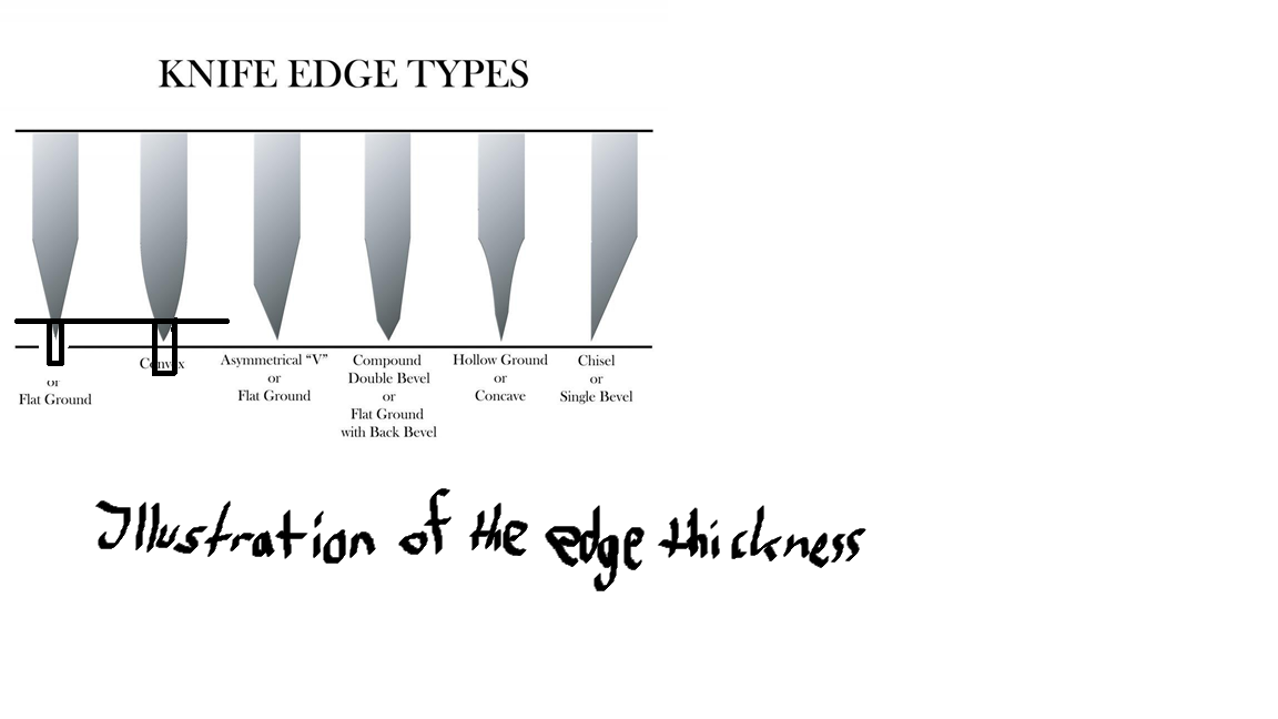

Well, not really. On a hollow ground blade the first few millimetres (so the edge itself) is very thin and has a very fine angle to it.
On a convex or lenticular grind the very edge remains fairly thick and has a very steep angle.
The thinner the primary grind is, the flatter the edge angel gets, which results in a very sharp but also vulnerable edge.
The thicker the primary grind it, the steeper gets the angle of the edge itself, which results in a thick and strong edge.
I have done some crude illustration on Paint in order to explain what I mean.

Secondly, lenticular doesn't mean thicker, it just means lens-shaped. You can have very thin lenticular blades, and the edge angle isn't nearly so steep as shown in the drawing, nor is it significantly different from a diamond or hex section, especially if the dimensions of the spine are kept the same for all three.
