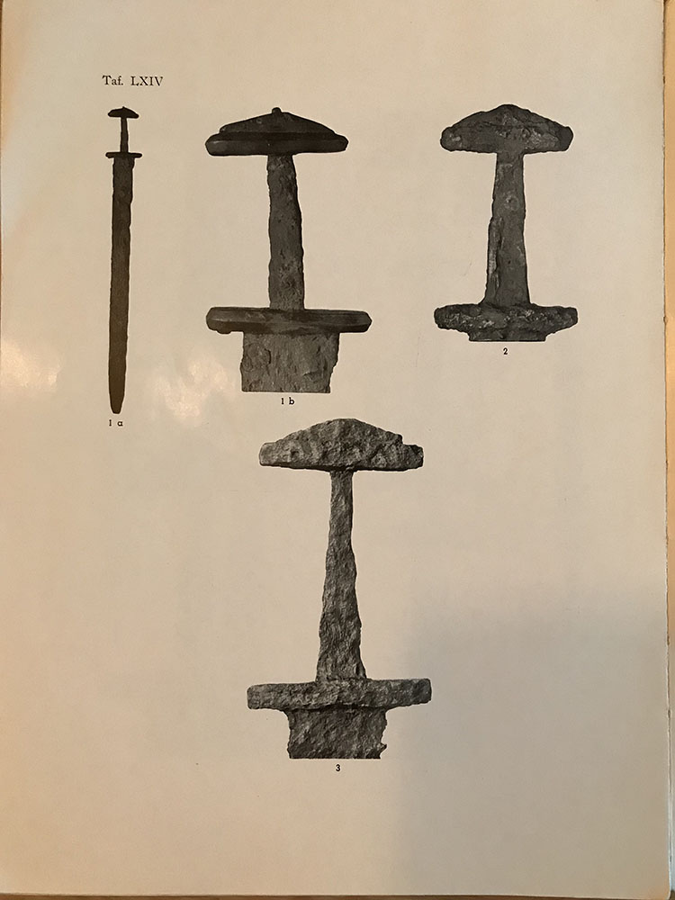

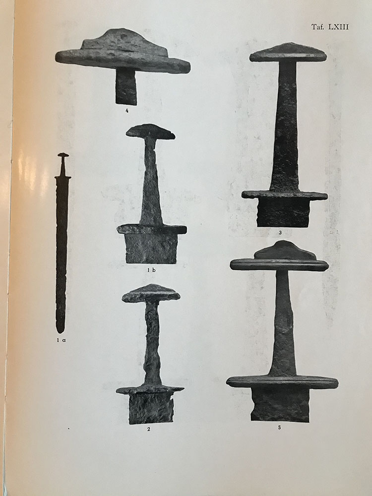

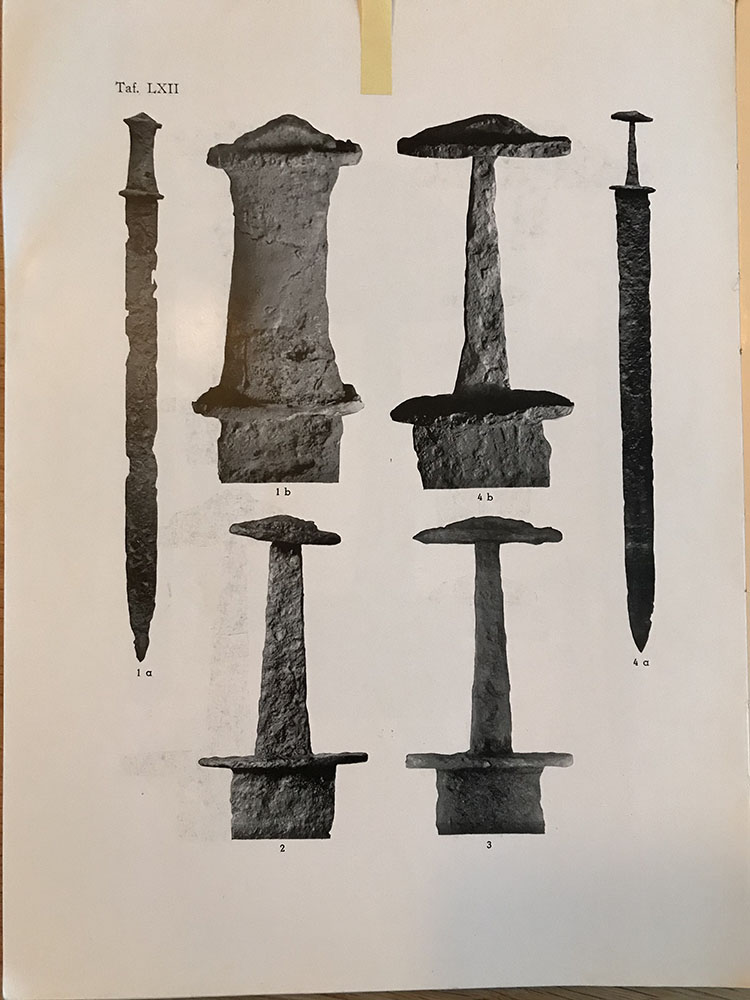

Posts: 845 Location: The Netherlands
Tue 29 Dec, 2020 10:40 am

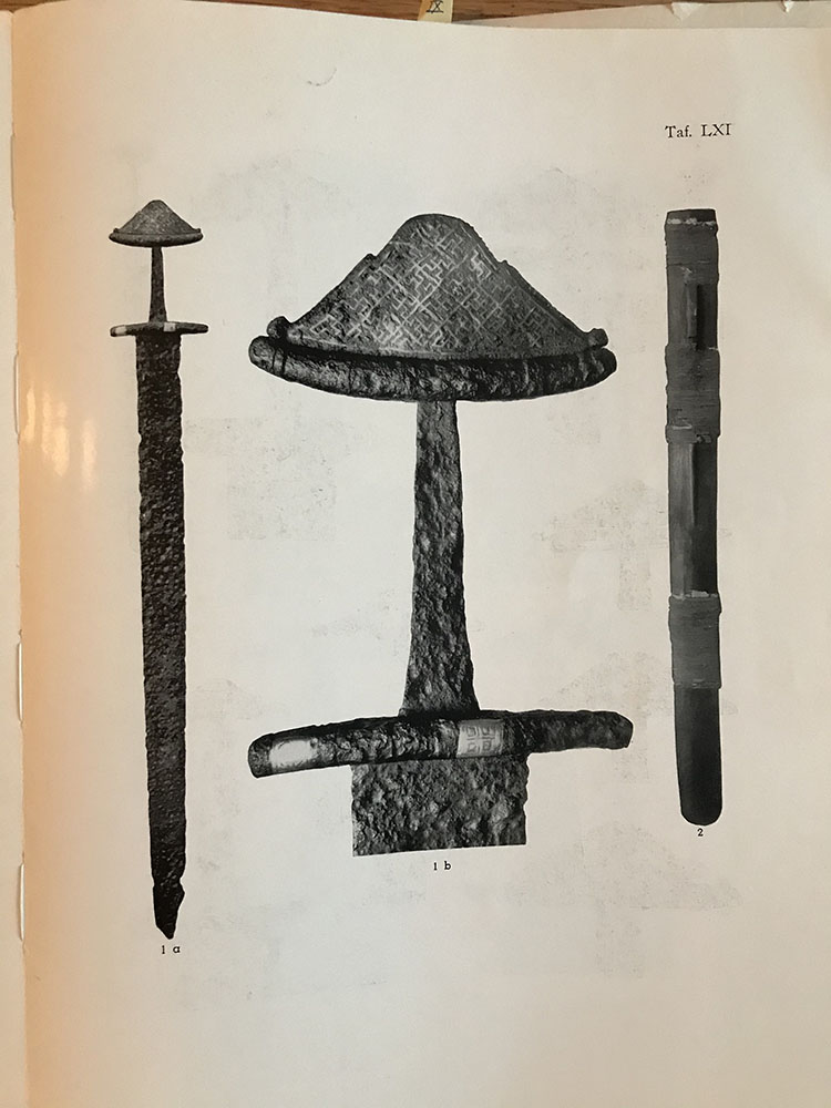

Here you go.
Tafel LXII - LXIV are type IX.
Attachment: 123.95 KB
Attachment: 111.76 KB
Attachment: 100.41 KB

Posts: 111
Tue 29 Dec, 2020 11:24 am
Paul,
Thanks for the pictures. Though do you know of any recreations of the behmer type 9 hilt for just before the Viking age? Having trouble finding modern recreations to see clearly without corrosion what the hilts should look like.
Thu 31 Dec, 2020 8:50 am
Well, Patrick Barta's swords 166 and 155 belong to the period immediately before the Viking Age but they are not Behmer Type 9. I'm not familiar with other reproductions of the type.

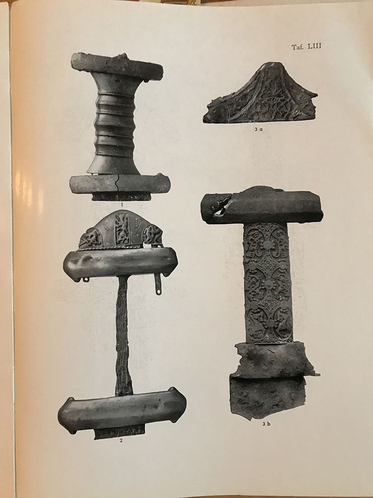

Paul--
Thank you. That all metal hilt with the 3 central section grip in that first photo is gorgeous. I want to see it replicated.
Wed 06 Jan, 2021 3:33 pm
| Kai Lawson wrote: |
Paul--
Thank you. That all metal hilt with the 3 central section grip in that first photo is gorgeous. I want to see it replicated. |
You're welcome!
One thing to remember when looking at photo's from Behmer: they were taken in the 1930's and are as displayed in the musea at that time. In several cases that's good because some swords badly deteriorated in the period around WW2. But also several swords pictured have been later re-assembled in different ways due to evolving understanding of how they must have looked originally.
For instance, some swords are depicted with crossguards, which actually turned out to be scabbard mouths. Or with pommels which turned out to be sword beads. Etc.
The grip of sword Tafel LIII.3b for instance also seems suspicious to me. It may not be a grip at all. So if you would like to have something replicated, you'll need to find more sources than just Behmer, and preferably go to see the sword yourself, see how it is in it's current state and then form your opinion.
