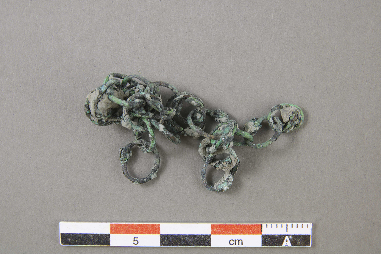

* a small cluster of what seems to be chain mail. There seems to be some kind of verdigris on the rings, which strikes me as odd because you'd expect the rings to made up pure iron? I might be totally wrong here as I'm no expert in armour, nor weapons.

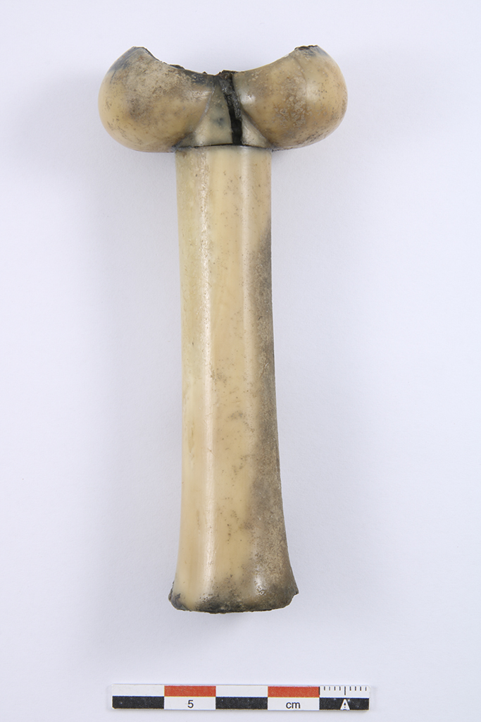

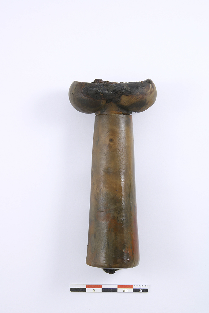

*two shafts of a bollock dagger. One in what is thought to be made of walrus tooth and one of wood. I'm interested in any information you might have on these types daggers. Stylistically they seem to be early, as the later bollock daggers tend to be more flamboyant?

The chains haven't been properly cleansed of mud since they are going in for conservation. [ Download ]

Walrus tooth shaft [ Download ]

Wooden shaft [ Download ]

European mail was occasionally tinned, and occasionally of copper alloys, which were sometimes tinned or gilt. The copper-alloy rings were often near the edge for decoration: I think Thom Richardson's PhD thesis and book point to examples.

Thank you for your response! I will look into Richardson's thesis right away. It could maybe explain why this part was preserved, while those rings that were not would be would have rusted away in the salty conditions which marine clay certainly provides.

I could very well be wrong, but at 9mm outer diameter and 7mm inner diameter, these rings seem on the very large size for mail.
That's not far from some existent mail.
While there is an idea that most mail was made of small fine rings like some Roman mail, that's often not the case.
Useing larger an thicker rings has a few advantages, first is the massively lower the amount of labour needed to draw the wire, make the rings, flatten them, piece them, weave them an rivet them.
Lower quality metal can be used as well.
Second as the rings are thicker, the rivets can bigger and the whole structure stronger, sure some points might just pass clean thru but there no way that rings can be cut or torn out.
Here's some examples.
Here's a 9 mm to 7mm diameter shirt.
Here's a 10mm shirt at the Royal armourys.
One with 12.6mm outer diameter .
The biggest rings i have found, at 17mm! outer diameter to 11mm.

The daggers are fantastically preserved and I suspect you are right in that that are very plain and 'workaday' pieces. So yes I suspect that you are right on them being earlier pieces. They probably had metal 'impact plates' at the base of the guard and I think I can see this on the wooden one, though less clear in the ivory one, but probably there.
The shaft and balls being split into two parts makes sense for the ivory one because of material size and this is something you sometimes see in bollock daggers for a few reasons, but for the plain wooden one (box wood?) this is far more unusual though curiously it is a better structural way of making this dagger type.
What is interesting is that these are very plain and I we would imagine the ivory one to be high status, but there is nothing about this piece that suggests anything other than 'workman' so was the ivory common enough to not be worth much up in Scandinavia?
