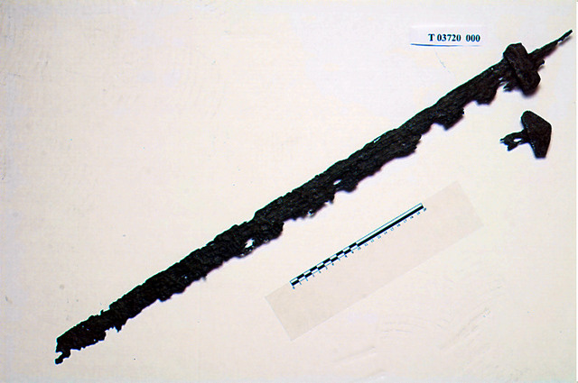

Tyler C.
Location: Canada
Joined: 20 Aug 2019
Posts: 166
PostPosted: Tue 16 Jun, 2020 3:27 pm    Post subject:         Reply with quote

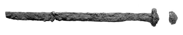

It's very hard to extrapolate 3 dimensions from 2D, but this example looks like it could be a type I Var I. I would call it a Petersen Type B.
From: http://www.unimus.no/artefacts/khm/search/?oi...amp;f=html

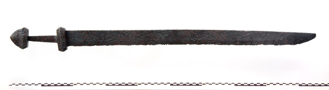

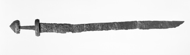

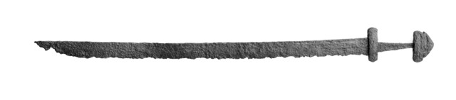

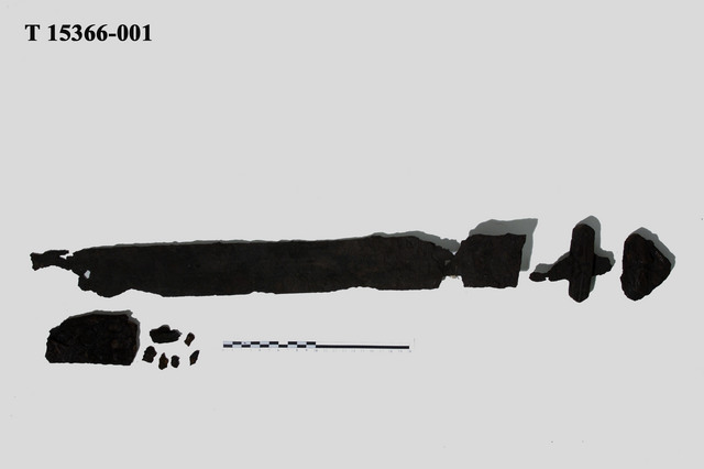

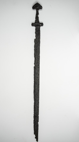

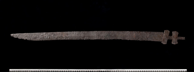

I did a bit more searching through the Norwegian museum catalogs (what a great resource BTW) and I found a few other hilts that may be of interest if you have not already seen them. I must confess I have a hard time specifically categorizing these hilts within Geibig's typology. One particular point of confusion for me is that from what I understand, the defining characteristic of a Petersen type B is the widening pommel. This would mean that all Geibig type 1 hilts are actually Petersen type H and type B is not categorized by Geibig. I would appreciate some correction on that if I am out to lunch. I also probably need to do some more reading on Geibig's work because for me there appears to be a lot of overlap. I find it difficult to firmly place any of these within his categories, but I think they all have characteristic that at least place them in the type 1 category. These are in no particular order.
From:http://www.unimus.no/artefacts/um/search/?oid=35641&museumsnr=B1142&f=html
From: http://www.unimus.no/artefacts/um/search/?oid...amp;f=html
From: http://www.unimus.no/artefacts/vm/search/?oid...amp;f=html
Yes it is. I wish all museums / countries had a database like that...
No, the defining characteristic between type B and type H is that in the type B, the tang protrudes through the pommel and is peened there. In the type B, the tang is peened through the upper guard and the pommel (pommel cap) is attached to the upper guard by rivets or by bands (in case of a hollow pommel and hollow guard):
Type H:
http://www.vikingsword.com/petersen/ptsn089h.html
http://www.vikingsword.com/petersen/ptsnf081.jpg
The widening pommel in the type B is something I don't really understand:
http://www.vikingsword.com/petersen/ptsn061b.html
In this translation it is stated that "The pommel is three-sided and of uniform width."
But this is actually not true for the one example of the type (sword C16001) that is pictured in Petersen's book.
No, quite the opposite. Geibig considers all type 1's and several type 5's (all except type 5 var 1) to fall in Petersen's type B categorisation, which makes type B far more popular in Germany than in Scandinavia. Petersen type H on the other hand consists only of Geibig type 5 var 1.
But the interesting part about that is that most of the German type 1 and 5 (except 5 var I) finds are from the area known as East Frisia (Ostfriesland). East Frisia was the last part of Frisia that was conquered by the Franks, namely as part of Charlemagne's Saxon wars (785). Afterwards, the region was formally Christianised which meant no more grave goods in the burials.
But the question is what that means. I really doubt that type B / type 1 is a late Merovingian / Carolingian type as suggested by some authors, because the Franks were at war with the Frisians and the Saxons. On the other hand the type seems to be relatively rare in Scandinavia. But characterising it as a Frisian type also seems a bit unlikely as most of Frisia was already conquered by the Franks between 720 - 734.
Thanks a lot!
Type H acc the text, but I doubt it, seems more like a B to me. Maybe they categorise it as H because of the stripes in the hilt which indicates it was previously inlayed with silver or bronze. Personally i wonder how relevant that is, although in the Scandinavian context there seems a strong correlation.
This kind of hilt is what I had in mind! Thanks!
What is also interesting is that the blade is curved like a sabre. I doubt that is how it was intended but maybe a form of damage (or warping during the hardening process?)
Type H, not only because of the inlay but also of the elliptical shape of the guards (when looking from the top).
Acc the text, type C, most likely because it's a single piece pommel.
Really difficult to say but I think type C
Also really difficult to say but I think type C
That may well be a type B, but not a Geibig 1 var 1 because the hilt ends seem pointed rather than squared.

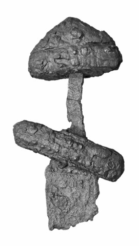

I found one more, with the help of Fedir Androshchuk's book Viking Swords:
https://upload.wikimedia.org/wikipedia/commons/4/4e/Nordic_Museum_-_contents_of_a_Viking_grave_and_other_warfare-related_items_03.jpg
Wow what a beauty! I love how the end of the upper guard turns upward. It is clearly a well made piece. Seeing this example makes me want one even more. Too bad the pommel cap is missing.
