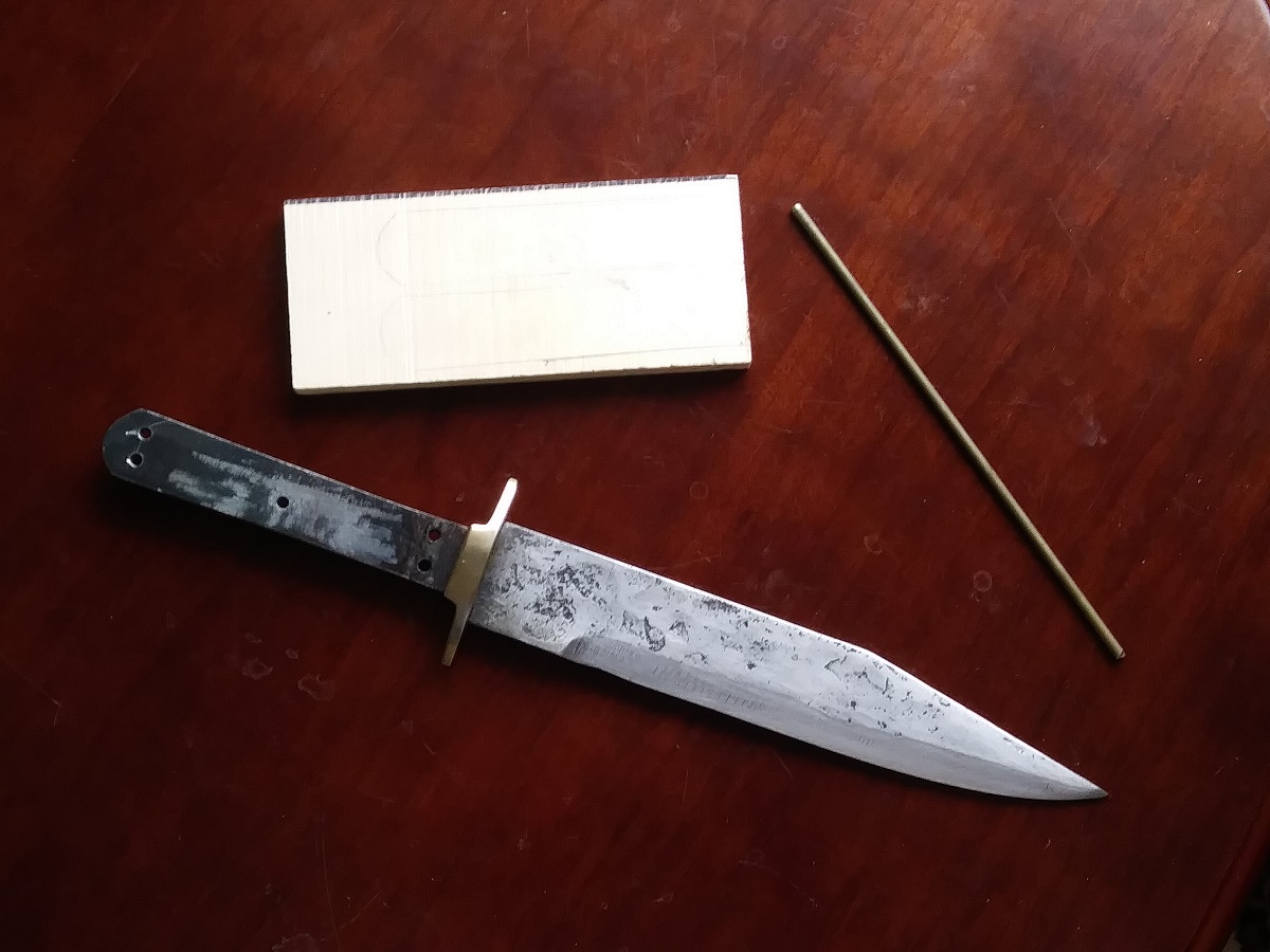

Hello again.
I've ordered a couple of unmounted Sheffield-style bowie blades, the kind with straight-edged slab tangs, similar to the attached image. I'm wondering how to make sure the hilts have a secure grip, given that they have straight edges and no widening at the butt end. Was the reason they were often given antler scales so the textured surface would make them grippier? If I use smooth wood grips, should I regrind the tang edges so that they flare at the end? Or am I worrying about nothing?
 Attachment: 59.32 KB

One thing you can do is make the grip scales grow slightly thicker away from the blade. Just a couple of millimeters thicker at the butt end often makes a surprisingly big difference!
And, of course, you can also file the sides of the tang to the more common slightly waisted shape (as shown in the attached image, or probably a little more pronounced depending on personal taste).

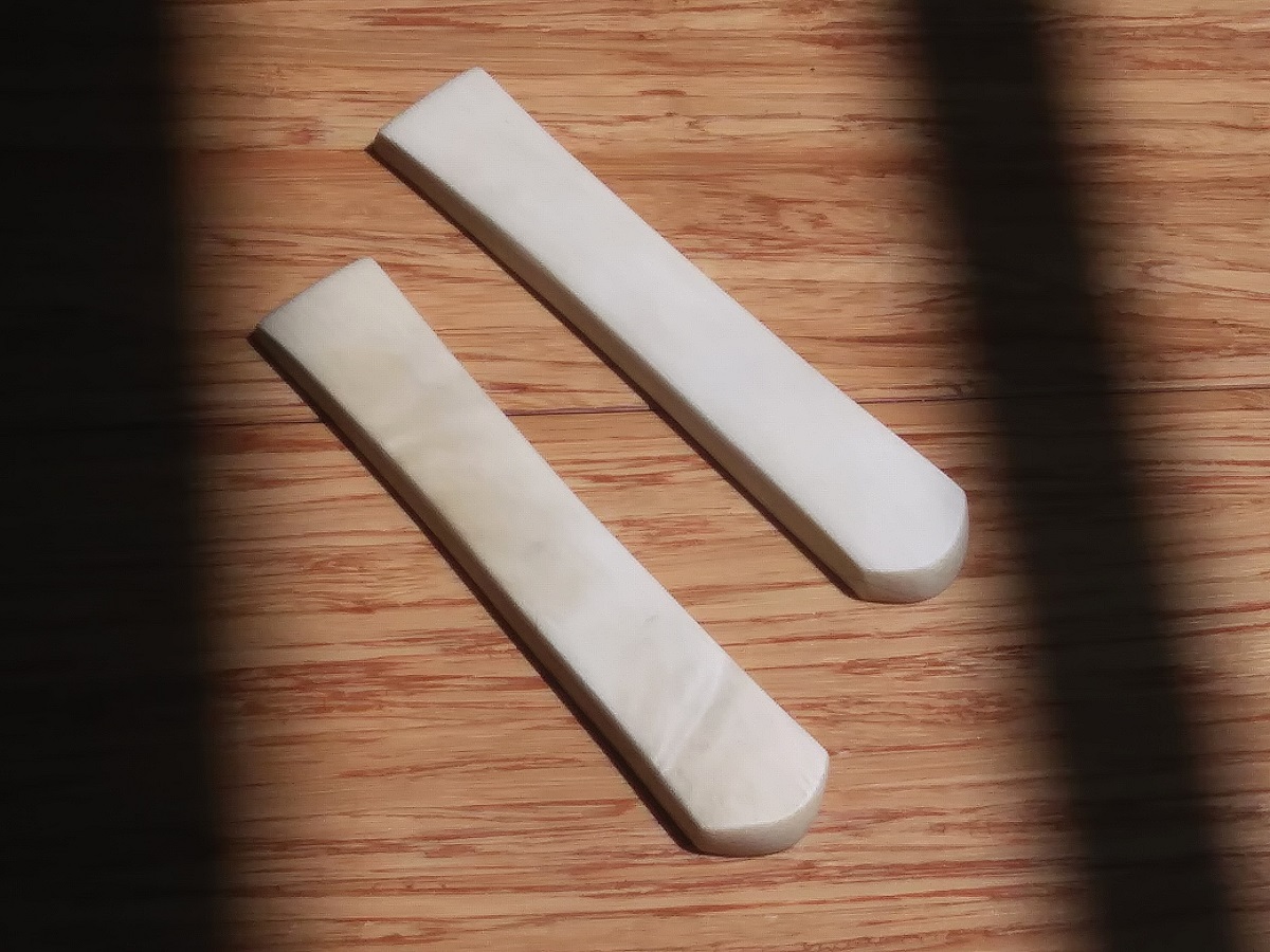

Bone is a good choice for a grip scale material, you can work it to a nice satin finish and it’ll still have a bit of tack, grippiness even when wet, at least to bare hands. Good chance that’s what the scales are in the photo you attached in your original post.
You can certainly flare the grip toward the butt, either in thickness or in height (reducing the tangs breadth close to the blade if needed), as Mikko states before, but many of the older bowies that I’ve seen are pretty narrrow and straight in the grip. A fatter butt is an advantage if you’re building a chopper, but might not be needed or even desireable for an all-purpose outdoors knife (which most Bowie knives were).

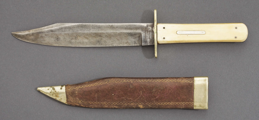

Here is a Sheffield style bowie made by Tod Cutler

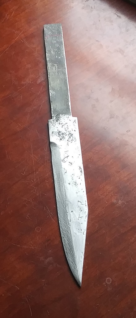

I managed to give the tang a very slight waist, but I felt the entire tang needed to be made narrower from end-to-end (and thinner) so as not to require making the slot in the guard so big as to weaken it. Drilled pin holes, shimmed and hard-soldered the guard, and I've got some holly for the grips. Also have some sheet nickel on order for the scabbard fittings and escutcheon plate.

Oh, I like that! Really nice subtle shape.

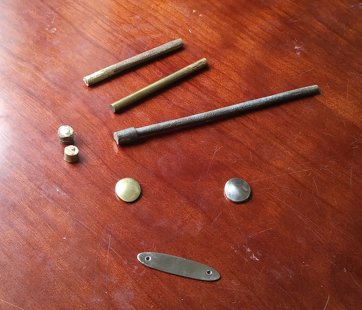

In the meanwhile, I have to ask about the frog buttons. Can I just silver-solder the head to the shank and the shank to the throat? How tall and wide should the shank be? Lastly, how do I design and build the frog sleeve and buttonhole so the button will go through the hole easily without the hole or sleeve being too loose?
For the frog sleeve one makes a hole the diameter of the shank and the frog has a slit in the top part leading to the hole, the scabbard is inserted into the frog shape first, the shank slips in the cut and ends up in the hole.
The button can be very much larger than the shank as the hole in the frog never had to get past the wider diameter of the button.
See the pics on this site of the Windlass 1880 bowie reproduction, the pics of the knife in the photo galler and sheath in the photo gallery clearly show what I'm attempting to describe.
https://www.reliks.com/bowie-knives/1880-bowie-knife/
Note one can use the frog for on the belt carry, but one can also use the shank and button by itself behind the belt close to one's body and the shank and button prevents the sheath from falling off the belt when one pulls the knife out.
Hope this helps. Wink Big Grin

Thanks. That seems like it'd work, provided the leather is left stiff. Perhaps water-molding and being careful about conditioning there.
I'm noticing that among the rare photos of originals that even have frogs, there doesn't seem to be one routine way they were made and attached to the scabbard.
