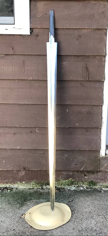

Blade polishing time. Some blemishes to 'iron out', some assembly...

PostPosted: Sun 10 Nov, 2019 6:50 am    Post subject:         Reply with quote
Eric is quite a perfectionist, he stayed up late to fix those blemishes. Here you can see the before and after.
