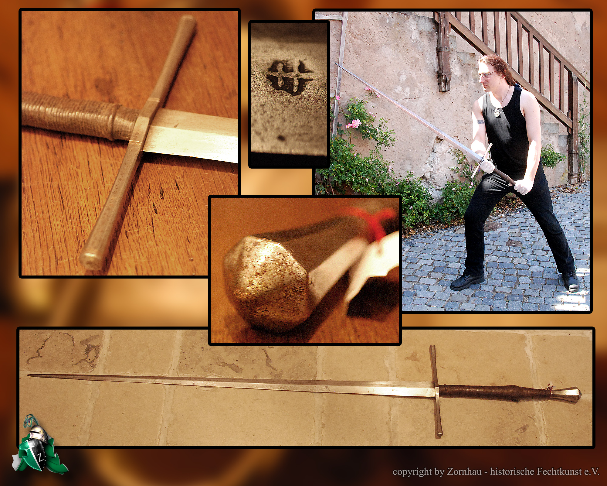

PostPosted: Sun 02 Feb, 2020 7:24 am    Post subject:         Reply with quote
I'm not sure what you are getting at but if you mean single handed spatha type swords in the 90 - 100 cm range overall, then that goes back before the Romans, and the Romans were certainly making weapons of that size and even a bit longer. Those are however also sometimes the swords which are of limited steel content. I know there were also some pattern welded spatha type swords though coming from places like Noricum fairly far back.
When I say longsword I'm referring to hand and a half weapons in the 110 - 140 cm+ range in overall length, such as became commonplace in the era of the fencing masters I was referring to in my posts, 14th - 16th Centuries. Swords which furthermore we know were used in fencing systems that did not require the use of shields for parrying. I think the latter is the common usage of the word 'longsword' for anything later than the Classical era.
The only really lengthy swords I know of in or near Europe prior to the High Medieval are a few quite interesting very long sabers which have been excavated in Central Asia, which appear to be specialized weapons. I don't know about their metallurgy. By the later medieval period the Chinese and Japanese had their Miao Dao / No Dachi type swords as well but that is contemporaneous to the longsword, montante, zweihander etc.
If you are talking about swords like this in the Roman era, or anywhere prior to say the 12th Century, that would certainly be an eye opener for me and I'd love to hear more about it.
J
